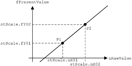

The FB_BA_AnalogInput function block is used to acquire and scale analog input signals.
The raw value nRawValue is converted into a physical value by linear interpolation with 2 interpolation points.

The structure contains the interpolation points for linear interpolation.
