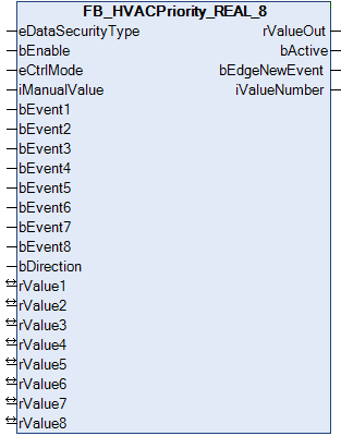

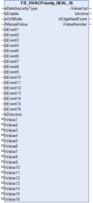

This function block can be used to prioritize events or as a multiplexer. This selection is made with the help of the Enum eCtrlMode.
The function block can be used to prioritize events if eCtrlMode = eHVACCtrlMode_Auto. The output rValueOut is controlled via the events occurring at the inputs bEvent1-16, rValue1-16 and the control direction of the prioritization bDirection.

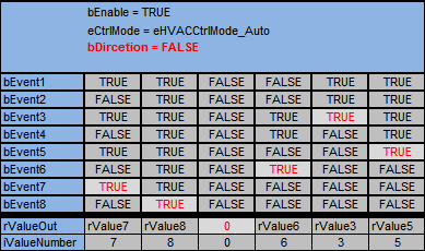

=FALSE means that the events have a higher priority in ascending form from 1 to 16. If bEnable = TRUE AND eCtrlMode = eHVACCtrlMode_Auto AND bDirection = FALSE AND bEvent15 = TRUE (highest occurring event in Table 1 column 1), then rValueOut has the value of rValue15.

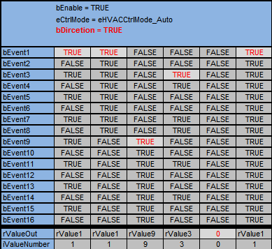

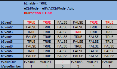

bDirection = TRUE means that the events have a higher priority in descending form from 16 to 1. If bEnable = TRUE AND eCtrlMode = eHVACCtrlMode_Auto AND bDirection = TRUE AND bEvent1 = TRUE (lowest occurring event in Table 2 column 1), then rValueOut has the value of rValue1.

Table 1: Prioritization of events in ascending form from 1 to 16
It can be seen in Table 1 that bDirection = FALSE. This means that the events determine the output value rValueOut in ascending form from 1 to 16. If bEnable = TRUE AND eCtrlMode = eHVACCtrlMode_Auto AND bDirection = FALSE AND bEvent15 = TRUE (highest occurring event in column 1), then rValueOut = rValue15.

Table 2: Prioritization of events in descending form from 16 to 1
It can be seen in Table 2 that bDirection = TRUE . This means that the events determine the output value rValueOut in descending form from 16 to 1. If bEnable = TRUE AND eCtrlMode = eHVACCtrlMode_Auto AND bDirection = TRUE AND bEvent1 = TRUE (lowest occurring event in Table 2 column 1), then rValueOut = rValue1.
