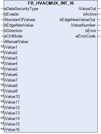

FB_HVACMUX_INT_16 1:
This function block contains two different types of multiplexers, one each for the operation modes eHVACCtrlMode_Auto or eHVACCtrlMode_Manual. This selection is made with the help of the Enum eCtrlMode.
The following conditions must first be fulfilled for this:
bEnable = TRUE AND bError = FALSE
If eCtrlMode = eHVACCtrlMode_Auto, the variable bDirection determines whether the output variable iValueNumber is incremented or decremented when using the input bEdgeNewValue. If bDirection = FALSE it is incremented, if bDirection = TRUE it is decremented.
If eCtrlMode = eHVACCtrlMode_Manual, the output iValueNumber is determined by the variable iManualValue. The variables iNumberOfValues, bEdgeNewValue and bDirection are not taken into account in this operation mode.
The output iValueNumber always indicates the number of the variable iValueX, whose content is output in the output variable iValueOut.

eDataSecurityType : E_HVACDataSecurityType;
bEnable           : BOOL;
iNumberOfValues   : INT;
bEdgeNewValue     : BOOL;
bDirection        : BOOL;
eCtrlMode         : E_HVACCtrlMode;
iManualValue      : INT;

iValueOut           : INT;
bActive             : BOOL;
bEdgeNewValueOut    : BOOL;
iValueNumber        : INT;
bError              : BOOL;
eErrorCode          : E_HVACErrorCodes;

iValue1-16        : INT;
iValue1-16: The value of the output variable iValueOut is determined by the variables iValue1 to iValue16. If iValueNumber = 6, then iValueOut = iValue6.
