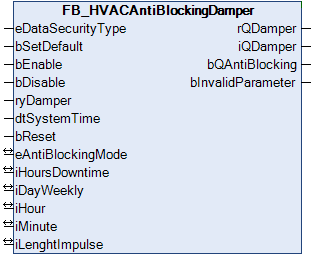

FB_HVACAntiBlockingDamper 1:
This function block prevents the blocking of an actuator over long time intervals with an unchanged control value. When activated, the blocking protection forces the actuator to drive from fully closed to fully open.
eDataSecurityType   : E_HVACDataSecurityType;
bSetDefault         : BOOL;
bEnable             : BOOL;
bDisable            : BOOL;
ryDamper            : REAL
dtSystemTime        : DT;
bReset              : BOOL;
Notice
bEnable: The AntiBlocking function is enabled by the input variable bEnable. If bEnable = FALSE, only the input value will be applied at the output; the AntiBlocking function is not active.
bDisable: Resets the outputs rQDamper, iQDamper and bQAntiBlocking to 0.
ryDamper: Control value from the controller to the valve, which is fed to the outputs rQDamper and iQDamper (0%..100%). The value must be smaller than 1 % in order for the function block to recognize this as standstill time. No standstill time will be determined for a valve with a control value >= 1 %.
dtSystemTime: System time
bReset: Acknowledge input in the event of a fault. Resets the flag bInvalidParameter.
eAntiBlockingMode : E_HVACAntiBlockingMode;
iHoursDowntime    : INT;
iDayWeekly        : INT;
iHour             : INT;
iMinute           : INT;
iLengthImpulse    : INT;
eHVACAntiBlockingMode: Enumeration value that specifies the type of Antiblocking method (see E_HVACAntiBlockingMode).
eHVACAntiBlockingMode_Off:= 0: Off
eHVACAntiBlockingMode_Downtime:= 1: After the expiry of a standstill time in hours, the Antiblocking-pulse will be routed to the bOut output.
eHVACAntiBlockingMode_Weekly:= 2: The antiblocking pulse is only generated on a certain day of the week and at a certain time, independent of how long the standstill has lasted.
The variable is saved persistently.
iHoursDowntime: For eHVACAntiBlockingMode_Downtime, the time in hours for which the input bIn may not be active until the AntiBlocking pulse is formed (0h..6000h). The variable is saved persistently. Preset to 24.
iDayWeekly: For eHVACAntiBlockingMode_Weekly, AntiBlocking pulse is formed on this day. Sun=0, Mon=1, Tue=2, Wed=3, Thu=4, Fri=5, Sat=6
The variable is saved persistently. Preset to 6.
iHour: Switch-on time in hours (0..23 h). The variable is saved persistently. Preset to 12.
iMinute: Switch-on time in minutes (0min..59min). The variable is saved persistently. Preset to 0.
iLengthImpulse: Switch-on time in seconds (0s..600s). The variable is saved persistently. Preset to 150.
rQDamper         : REAL;
iQDamper         : INT;
bQAntiBlocking   : BOOL;
bInvalidParameter: BOOL;
rQDamper: This output corresponds to the input value of the control value (0%..100%). As soon as the input bEnable is TRUE, the Antiblocking pulse is additionally applied to the output. 100 % is present at the output when the Antiblocking state is reached.
iQDamper: This output behaves like rQDamper, but in order to suit an analog output it is output as an integer value from 0 - 32767, corresponding to 0 - 100 %.
bQAntiBlocking: This output is independent of the switch-on signal and shows only the Antiblocking-pulse.
bInvalidParameter: An error occurred during the plausibility check. It is deleted again by bReset.
