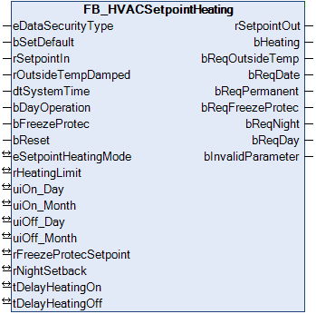

FB_HVACSetpointHeating
FB_HVACSetpointHeating 1:
By using this function block a heating circuit can be switched through different operation modes. Depending on the operation mode a corresponding setpoint for controlling the supply air temperature of a static heating circuit is output from the function block. The output bHeating is set or reset depending on the operation mode and the state of the parameters described below.
For functional reasons this function block must be used together with the function block FB_HVACHeatingCurve. The reason for this is that the value for the night setback is taken into account in FB_HVACHeatingCurve.

Notice
bEnable: The function block is activated if the variable bEnable is TRUE. If it is FALSE, zero will be output at rSetpointOut and the pump output remains FALSE.
rSetpointIn: In the case of a heating circuit controlled by the room temperature, the value of a room setpoint module is applied at rSetpointIn. If the heating circuit is controlled by the outside temperature, the setpoint comes from the heating characteristic curve. See FB_HVACHeatingCurve.
rOutsideTempDamped: Short-term fluctuations in the outside temperature must not be allowed to have an unfiltered effect on the setpoint of the flow temperature. For this reason the outside temperature must not be connected directly, but rather via a damping function block. See also FB_HVACOutsideTempDamped regarding this point.
dtSystemtime: This variable transfers the computer system time to the function block.
bDayOperation: The output variable of the program is transferred at this input variable. If bDayOperation is TRUE, then the heating circuit is in day operation mode. The night setback of the flow temperature is hence deactivated.
bFreezeProtec: Input to which the frost protection signal is applied.
bReset: Acknowledge input in the event of a fault.

rSetpointOut: Setpoint for the supply air temperature control.
bHeating: The output bHeating is set (TRUE) or reset (FALSE) immediately or after a delay, depending on the selected operating mode as well as the switch-on and switch-off delays. The output can be used to enable the controller.
bReqOutsideTemp: The heating circuit is in the operating mode ‘heating period according to outside temperature’.
bReqDate: The heating circuit is in the operating mode ‘heating period according to date’.
bReqPermanent: The heating circuit is in the operating mode ‘heating circuit always on’.
bReqFreezeProtec: The heating circuit is in the operating mode ‘frost protection mode’.
bReqNight: The heating circuit is in the operating mode ‘night operation’.
bReqDay: The heating circuit is in the operating mode ‘day operation’.
bInvalidParameter: Indicates that there is an incorrect input parameter. bInvalidParameter must be acknowledged with bReset.

eSetpointHeatingMode: Enum that specifies the operation mode of the heating circuit (see E_HVACSetpointHeatingMode). The variable is saved persistently. Preset to 1.
rHeatingLimit: Heating limit (-60°C..100°C). Necessary for the operation modes of the heating circuit; heating period according to the outside temperature and heating period according to the date. The variable is saved persistently. Preset to 19.
uiOn_Day: Switch-on day of the month. Necessary for the operation mode ‘heating period according to date’. The variable is saved persistently. Preset to 1.
uiOn_Month: Switch-on month of the year. Necessary for the operation mode ‘heating period according to date’. The variable is saved persistently. Preset to 9.
uiOff_Day: Switch-off day of the month. Necessary for the operation mode ‘heating period according to date’. The variable is saved persistently. Preset to 1.
uiOff_Month: Switch-off month of the year. Necessary for the operation mode ‘heating period according to date’. The variable is saved persistently. Preset to 5.
rFreezeProtecSetpoint: Setpoint for the heating circuit in frost protection mode (0°C..100°C). The variable is saved persistently. Preset to 8.
rNightSetback: rNightSetback specifies the value for the night setback in °C (0°C..100°C). rNightSetback is taken into account in the operation mode eHVACSetpointHeatingMode_OnNight. The variable is saved persistently. Preset to 10.
tDelayHeatingOn: Time delay for the setting of the output bHeating to TRUE after the damped outside temperature has undershot the heating limit or the date has been reached (0h..100h). The variable is saved persistently. Preset to 0.
tDelayHeatingOff: Time delay for the resetting of the output bHeating to FALSE after the damped outside temperature has exceeded the heating limit or the date has been reached (0h..100h). The variable is saved persistently. Preset to 0.
