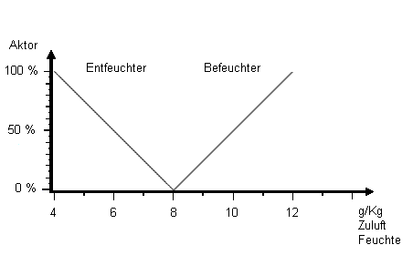

Besides the temperature, the humidity of the air is also controlled in some air conditioning systems. Steam humidifiers or air washers are used for humidification. For dehumidification the supply air can be cooled down to the dew point by a cooler. As a result, the moisture in the air condenses on the air cooler. The control of humidification and dehumidification is realized with a sequence incuding a humidification controller and a dehumidification controller.

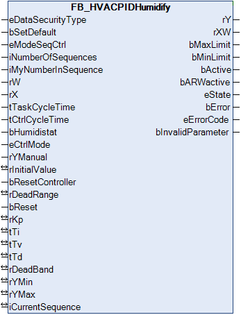

PID humidification controller
This function block is a special application of a PID controller. The humidity controller is only enabled if the function block input bHumidistat is TRUE.
eDataSecurityType : E_HVACDataSecurityType;
bSetDefault : BOOL;
eModeSeqCtrl : E_HVACSequenceCtrlMode;
iNumberOfSequences : INT;
iMyNumberInSequence : INT;
rW : REAL;
rX : REAL;
tTaskCycleTime : TIME;
tCtrlCycleTime : TIME;
bHumidistat : BOOL;
eCtrlMode : E_HVACCtrlMode;
rYManual : REAL;
bResetContoller : BOOL;
bReset : BOOL;

rY : REAL;
rXW : REAL;
bMaxLimit : BOOL;
bMinLimit : BOOL;
bActive : BOOL;
bARWactive : BOOL;
eState : E_HVACState;
bError : BOOL;
eErrorCode : E_HVACErrorCodes;
bInvalidParameter : BOOL;
