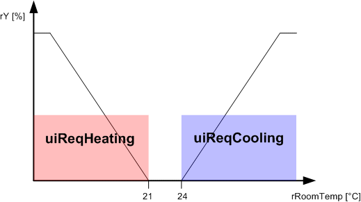

Sketch:

In both 2 and 4 pipe systems the changeover between heating operation and cooling operation can be delayed by a timer. The input variable udiChangeOverDelay must be greater than zero for this.

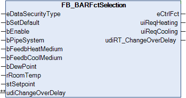

eDataSecurityType : E_HVACDataSecurityType;
bSetDefault : BOOL;
bEnable : BOOL;
bPipeSystem : BOOL;
bFeedbHeatMedium : BOOL;
bFeedbCoolMedium : BOOL;
bDewPoint : BOOL;
rRoomTemp : REAL;
stSetpoint : ST_BARSetpointRoom;eDataSecurityType: If eDataSecurityType:= eHVACDataSecurityType_Persistent, the persistent VAR_IN_OUT variables of the function block are stored in the flash of the computer if a value changes. For this to work, the function block FB_HVACPersistentDataHandling must be instanced once in the main program, which is called cyclically. Otherwise the instanced FB is not released internally.
Notice | |
A cyclically changing variable must never be linked with the IN_OUT variable of a function block, if eDataSecurityType:= eHVACDataSecurityType_Persistent. It would lead to early wear of the flash memory. |
bEnable: TRUE enables the function block. If FALSE the function block is disabled and eCtrlFct := eHVACCtrlFct_Off.
bPipeSystem: FALSE means that a 2 pipe system is present. TRUE means that a 4 pipe system is present.
bFeedbHeatMedium: Signal from the power generation or distribution that heating medium is available.
bFeedbCoolMedium: Signal from the power generation or distribution that cooling medium is available.
bDewPoint: The dew point sensor is connected to this input. If this is triggered the cooling control function is deactivated and eCtrlFct := eHVACCtrlFct_Off is set.
rRoomTemp: This input variable transfers the current room temperature to the function block.
stSetpoint: STRUCTURE containing the setpoints for the individual energy levels (see ST_BARSetpointRoom).
eCtrlFct : E_BARCtrlFct;
uiReqHeating : UINT;
uiReqCooling : UINT;
udiRT_ChangeOverDelay : UDINT; eCtrlFct: This output contains the current control function (see E_BARCtrlFct).
uiReqHeating: is 1 if the room/zone requests heating energy. It is 0 if there is no heating requirement.
uiReqCooling: is 1 if the room/zone requests cooling energy. It is 0 if there is no cooling requirement.
udiRT_ChangeOverDelay: Indicates the time remaining until the active control function is changed over.
uiChangeOverDelay : UINT;uiChangeOverDelay: Changeover time between the control functions. Must be specified in seconds. If the input is greater than 0 it will always be observed. The variable must be 0 if there is to be no changeover time between the control functions. The variable is saved persistently. Preset to 0.
