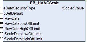

FB_HVACScale 1:

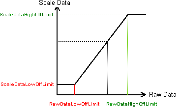

A raw analog value is scaled to the specified measuring range and returned as the function value. If the raw value extends beyond the upper or lower measuring range, the corresponding limit value is output. There must be a difference of at least 0.01 between the upper and lower limit values for the raw data. If this is not the case, the lower limit value is output. The difference between the limits is necessary so as to avoid division by zero during the internal calculation of the linear equation.
FB_HVACScale 2:
eDataSecurityType    : E_HVACDataSecurityType;
bSetDefault          : BOOL;
rRawData             : REAL;
Notice
rRawData: Raw value from the terminal.
rScaledValue         :  REAL;
rScaledValue: Scaled value.
rRawDataLowOffLimit     :  REAL;
rRawDataHighOffLimit    :  REAL;
rScaleDataLowOffLimit   :  REAL;
rScaleDataHighOffLimit  :  REAL;
rRawDataLowOffLimit: Lower limit for raw value. The variable is saved persistently. Preset to 0.
rRawDataHighOffLimit: Upper limit for raw value. The variable is saved persistently. Preset to 32767.
rScaleDataLowOffLimit: Lower limit of scaled measured value. The variable is saved persistently. Preset to 0.
rScaleDataHighOffLimit: Upper limit of scaled measured value. The variable is saved persistently. Preset to 100.

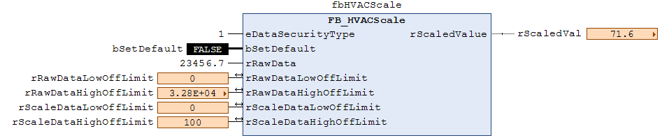

Example in FBD:
FB_HVACScale 3:
