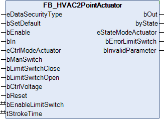

FB_HVAC2PointActuator 1:
This function block serves to control two-point valves or two-point dampers.
eDataSecurityType      : E_HVACDataSecurityType;
bSetDefault            : BOOL;
bEnable                : BOOL;
bIn                    : BOOL;
eCtrlModeActuator      : E_HVAC2PointActuatorMode;
bManSwitch             : BOOL;
bLimitSwitchClose      : BOOL;
bLimitSwitchOpen       : BOOL;
bCtrlVoltage           : BOOL;
bReset                 : BOOL;
Notice
bEnable: The function block is enabled by the PLC program with the input variable bEnable. The actuator always remains closed as long as the function block is not enabled. Output bOut is permanently FALSE.
bIn: In automatic mode the actuator is closed by a FALSE and opened by a TRUE.
eCtrlModeActuator: Enum that defines the operation mode (see E_HVAC2PointActuatorMode).
bManSwitch: if the two-point drive has a manual/emergency switch in the control cabinet, this can be connected to the input bManSwitch; the status of the manual/emergency switch will then be monitored. If bManSwitch = FALSE, then output bOut of the drive will be set to FALSE.
bLimitSwitchClose: Actuator feedback TRUE when the actuator is completely closed.
bLimitSwitchOpen: Actuator feedback TRUE when the actuator is completely open.
bCtrlVoltage: The parameter bCtrlVoltage serves to check the control voltage. The control voltage is present if the bCtrlVoltage variable is TRUE. The feedback control is suppressed if the control voltage fails.
bReset: Acknowledge input in the event of a fault.
bOut                  : BOOL;
byState               : BYTE;
eStateModeActuator    : E_HVAC2PointActuatorMode;
bErrorLimitSwitch     : BOOL;
bInvalidParameter     : BOOL;
bOut: The actuator is connected to this output (FALSE = closing drive; TRUE = opening drive).
byState: Shows the status of the control of the actuator:
byState.0:= Enable
byState.1:= Manual Switch
byState.2:= Enable Feedback Control
byState.3:= Control Voltage
byState.4:= Reset
byState.5:= bOut
eStateModeActuator: Indicates which operation mode the actuator is in (see E_HVAC2PointActuatorMode).
bErrorLimitSwitch: Goes TRUE if no limit switch is triggered after the preset stroke time. bErrorLimitSwitch is acknowledged with a positive edge on the input bReset.
bInvalidParameter: TRUE if an error has occurred during the plausibility check. The message must be acknowledged with bReset.
bEnableLimitSwitch : BOOL;
tStrokeTime        : TIME;
bEnableLimitSwitch: If the input is TRUE, then the function control of the drive is activated by means of the limit switch. The variable is saved persistently.
tStrokeTime: In order to set the function control correctly, the stroke time of the drive from fully closed to fully opened drive must be entered here (0s..3600s). The variable is saved persistently. Preset to 200 s.
