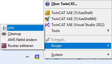

Monitoring the router memory
Even if the router memory is set in the project, this is a system-wide setting. Therefore, the router memory set in the project and currently used on the system can be viewed on the target system. To do this, right-click the TwinCAT icon in the Windows taskbar and select Router > Info.
