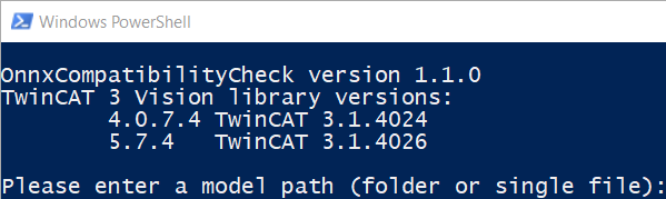

After executing the script, the version information is displayed first. First from the application itself and then to the TwinCAT 3 Vision library versions to which the compatibility refers. As a user, you will be asked to specify a folder or model path. If a folder containing several ONNX models is specified, these are tested in alphabetical order. It is also possible to explicitly specify a model, e.g. "C:\ONNX_Samples\LemonModel.onnx".

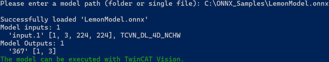

A successful execution looks as follows, e.g. using the Lemon Sample model:

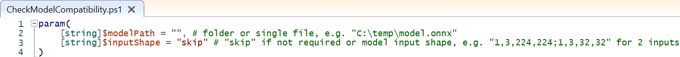

When the user opens the script for editing, he will find the parameters $modelPath and $inputShape in lines 2 and 3. The first parameter $modelPath is empty by default, so that the user is prompted to enter the path. Alternatively, a folder or model path can be stored in the script. In this case, the user is not prompted to make an entry and the stored path is used directly.
By default, the word "skip" is stored for the second optional $inputShape parameter, so that this query does not appear and the application is executed without the option. A fixed value, such as "1 3 224 224", can also be specified here for a single input. If there are several inputs, the entries must be separated by semicolons, e.g. "1,3,224,224;1,3,32,32" for two inputs. Alternatively, the word "skip" can be deleted so that the user is prompted to enter it. This prompt for the "Model Input Shape" can also be skipped by pressing "Enter" when executing the script.

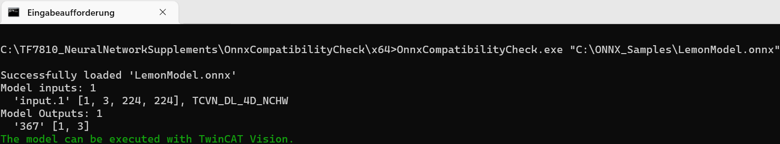

The "OnnxCompatibilityCheck.exe" can be executed directly without a Power Shell script. In the Windows command prompt, the successful test of the Lemon Sample model looks like this, for example:

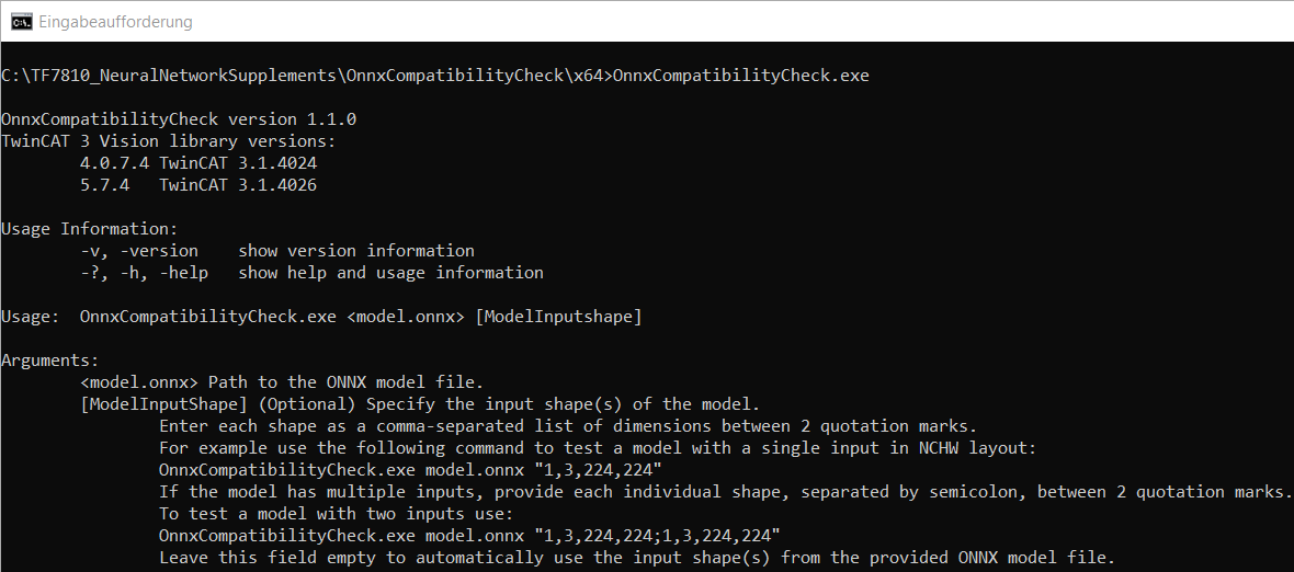

If only the name of the application is specified or -?, -h, -help is added and then confirmed with Enter, the following information and notes on the application are displayed.

- If the ONNX model could be loaded successfully, this is displayed as the first information, including the file name.
- This is followed by information on the input and output layers of the model, which are read from the ONNX file:
- For the input layers, the number is output first, followed by a list of the layers with the respective designation and the form of the tensor in square brackets. The number of elements in the respective dimension is displayed.
- If an input layer has more than two dimensions, the ETcVnDataLayout for the conversion (F_VN_ConvertDataLayout) from a 2D image to the respective input format of the model is also output. As a prerequisite for the correct recognition of the
ETcVnElementType, it is assumed that N (number of samples or batch size) = 1 and the number of channels is smaller than the width or height. - For the input layer of the Lemon Sample Model, for example, this looks like this: “Model inputs: 1 ‘input.1’ [1, 3, 224, 224], TCVN_DL_4D_NCHW”.
- For a model with several input layers, this looks like this, for example: "Model inputs: 3 'input.0' [1, 3, 224, 224], TCVN_DL_4D_NCHW 'input1' [1, 5] 'input2' [1, 10]"
- For the output layers, the number is output first, followed by a list of the layers with their names and the shape of the tensor. The number of elements in the respective dimension is displayed.
- For the output layer of the Lemon Sample model, for example, it looks like this:
"Model outputs: 1
