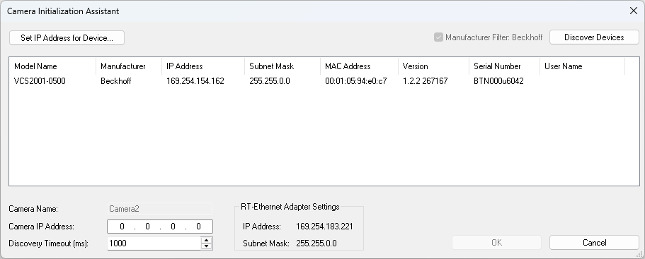

Only cameras from Beckhoff can be linked and operated with a Beckhoff camera object. The manufacturer filter is therefore always active in the Camera Initialization Assistant and cannot be deselected by the user. When establishing a camera connection, this is also checked so that use in the Configuration Assistant and in Run Mode is only possible with cameras from Beckhoff.
