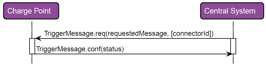

RecvTriggerMessage
With this method, an OCPP client receives a Trigger Message request from the corresponding OCPP server. To respond to the request, the method RespTriggerMessage must be called.
