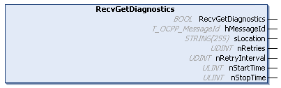

RecvGetDiagnostics

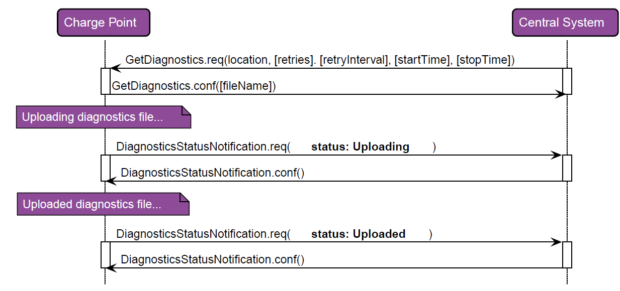

With this method, an OCPP client receives a Get Diagnostics request from the corresponding OCPP server. To respond to the request, the method RespGetDiagnostics must be called.
Syntax
METHOD RecvGetDiagnostics : BOOL
hMessageId : T_OCPP_MessageId;
sLocation : STRING(255);
nRetries : UDINT;
nRetryInterval : UDINT;
nStartTime : ULINT;
nStopTime : ULINT;
Return value
Name | Type | Description |
RecvGetDiagnostics | BOOL | The method returns the return value TRUE if the call was successful. A method call is also considered successfully completed in the event of an error. |
Outputs
hMessageId | MessageId of the received message. | |
sLocation | STRING(255) | Contains the directory to which the diagnostic file is to be uploaded. |
nRetries | UDINT | Optionally contains the number of attempts the Charge Point has made to upload the file. |
nRetryInterval | UDINT | Optionally contains the number of seconds after which the upload is retried. |
nStartTime | ULINT | Optionally marks the oldest point in time to be integrated into the diagnostic file. |
nStopTime | ULINT | Optionally marks the most recent point in time to be integrated into the diagnostic file. |
