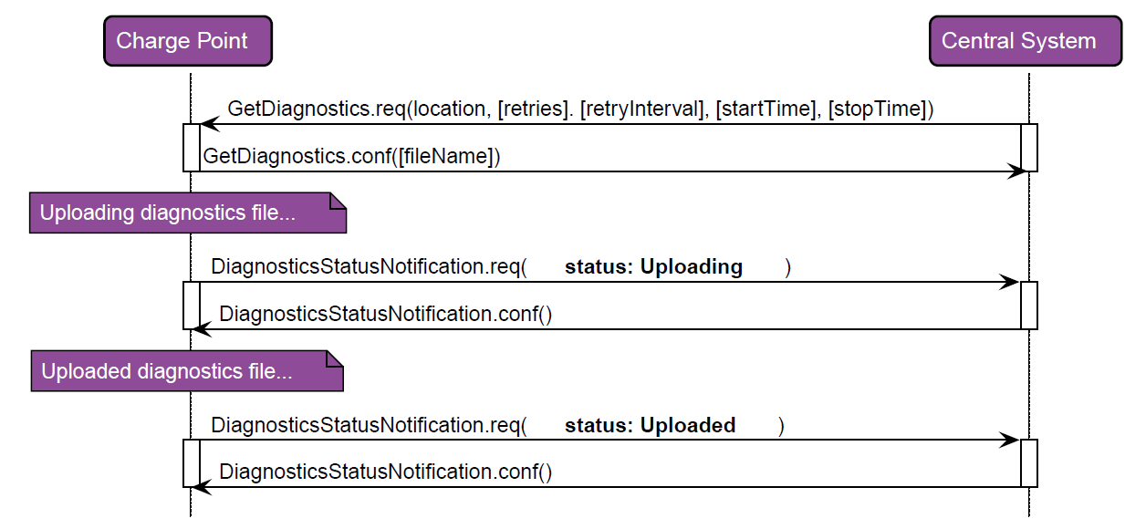

With this method, an OCPP client responds to a Get Diagnostics request from the corresponding OCPP server.

The method returns the return value TRUE if the call was successful. A method call is also considered successfully completed in the event of an error.

sFileName
STRING(255)
Optionally contains the file name of the diagnostic file that is uploaded.
