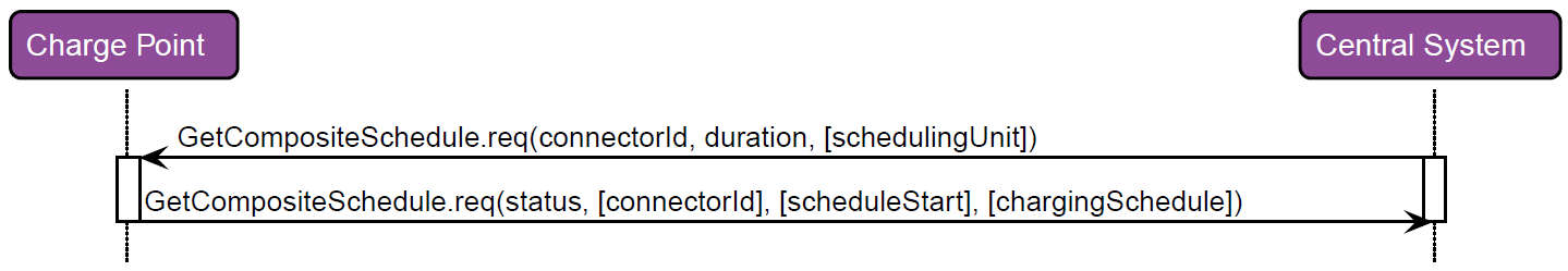

With this method, an OCPP client receives a Get Composite Schedule request from the corresponding OCPP server. To respond to the request, the method RespGetCompositeSchedule must be called.
