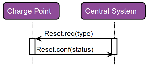

With this method, an OCPP client receives a Reset request from the corresponding OCPP server. To respond to the request, the method RespReset must be called.

hMessageId | MessageId of the received message. | |
eType | Type of reset that the Charge Point should perform. |
