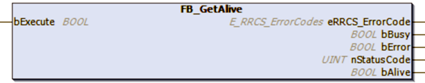

FB_GetAlive
FB_GetAlive 1:
To ensure that there is a correct connection between TwinCAT and the RRCS server, the function block FB_GetAlive can be used.
FB_GetAlive 2: Inputs
    bExecute : BOOL;
Type
bExecute
The function block is enabled by a positive edge at this input.
FB_GetAlive 3: Outputs
    eRRCS_ErrorCode : E_RRCS_ErrorCodes;
    bBusy           : BOOL;
    bError          : BOOL;
    nStatusCode     : UINT;
    bAlive          : BOOL;
Type
eRRCS_ErrorCode
E_RRCS_ErrorCodes
Error code received from RRCS_Servers.
bBusy
Is TRUE as long as the function block is busy with the query and no error occurs.
Is TRUE if an error occurred during the query.
nStatusCode
UINT
Servers deliver the status code as a response to every HTTP request.
The server uses this code to inform the client whether the request was successful.
Normally 200 (OK) is returned.
Detailed information on this:
developer.mozilla.org/en/docs/Web/HTTP/Reference/Status
bAlive
Is TRUE if communication to the RRCS server is working.
FB_GetAlive has an extended FB_init method in which an instance of FB_RRCScom must be referenced using a pointer:
fbGetAlive: FB_GetAlive(pfbRRCscom := ADR(fbRRCScom));
