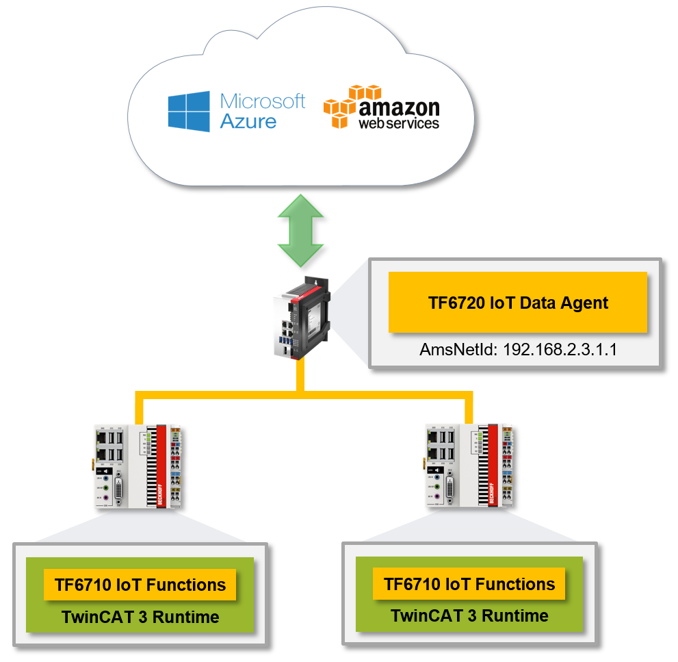

If TC3 IoT Functions and TC3 IoT Data Agent are installed separately and the components are placed on different computers, the function blocks need to specify the location of the TC3 IoT Data Agent installation. This can be done via the AMS Net ID of the device that executes the TC3 IoT Data Agent. Simply enter the AMS Net ID of the device that executes TC3 IoT Data Agent in the corresponding input parameter of function block FB_IotFunctions_Connector. Note that in this case an ADS route between the devices has to be created.
If TC3 IoT Data Agent and TC3 IoT Functions are running on the same device, the local AMS NET ID is used by default.
fbConnector : FB_IotFunctions_Connector := (sAmsNetId := 192.168.2.3.1.1');
