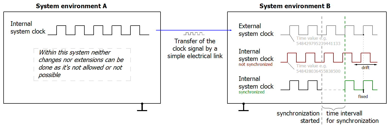

Application example: external synchronization of a system environment (B) from a non-modifiable system environment (A)
![]() | In the following sections, system environment (A) is regarded as the master system (from any manufacturer), system environment (B) is regarded as the slave system (TwinCAT only). |
