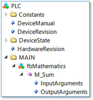

The method M_Sum is located in the function block FB_Mathematics. The declaration of the function block instance uses the PLC attribute that has enabled the function block and thus the method for OPC UA access.
PROGRAM MAIN
{attribute 'OPC.UA.DA':='1'}
fbMathematics : FB_Mathematics;

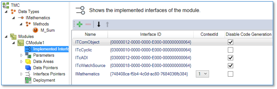

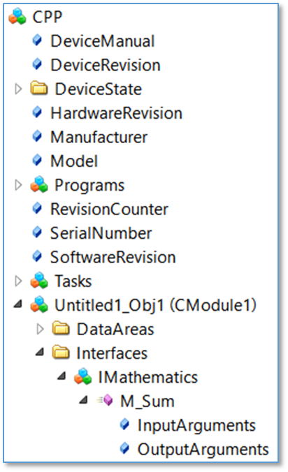

Methods in TwinCAT 3 C++

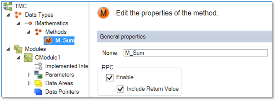

TwinCAT modules could implement interfaces with predefined methods (see TcCOM modules). The method itself must be enabled for RPC calls during its definition (see TwinCAT Module Class Wizard documentation) so that the OPC UA Server knows that it is ready for execution.
So that the return value of the method is available, the corresponding option Include Return Value must be activated. Note that the interface under which the method was created must be implemented.

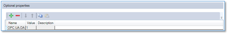

Depending on the import mode used, you have to declare the method for the access via OPC UA. This can be done by using the TMC Code editor and the usual OPC UA attributes as optional properties.
