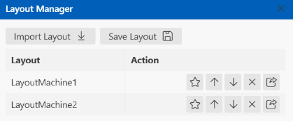

Layout Manager
The Layout Manager displays your saved layouts and offers additional options.
Selection | Description |
| Sets this layout as the default layout for future UIs of the same object type. For example, if the UI layout for an axis is marked with a star, the layout specified here will be used in the UI for every newly inserted axis object. This setting applies to the entire engineering system and is not limited to a single project. |
| Imports an existing layout into the project. |
| Saves the current UI layout within the project. Another window will open so you can enter a name. If an existing layout name is used, the existing layout will be overwritten. |
| Changes the order of your layouts. You can use the arrow keys to move a layout up or down in the list. |
| Deletes the corresponding custom layout. |
| Export the layout you created so that it can be used in other projects as well. Next, you must specify the storage location. |
