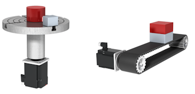

Incremental
The Incremental setting does not use the absolute properties of the physical feedback system, but can be used with both incremental and absolute encoder systems. After starting the controller, homing is required to initialize the actual position of the axis (IsPositionValid = FALSE).
Usage: This setting is suitable, among other things, for axes that move continuously in a coordinate direction. Examples of such mechanisms include rotary indexing tables, conveyor belts, and linear axes with incremental encoders.

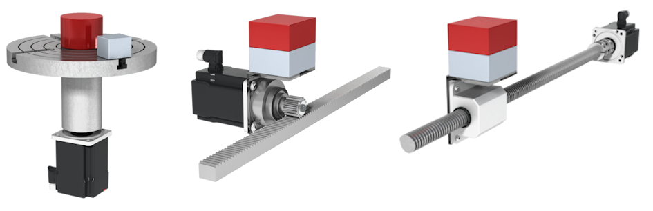

AbsoluteFullRange
The AbsoluteFullRange setting is typically used with multi-turn or single-turn absolute encoders. The MC3 axis takes into account the entire data range of the data type in the I/O device mapping (FullRange). The maximum number of increments corresponds to the upper limit of the data type. The size of the data type is specified in the protocol used.
When the controller is powered on or restarted, and position limits are enabled, the axis signals IsPositionValid = TRUE. Configuring and enabling the software-based position limits for the axis allows the axis position to be restored after the controller is restarted. This applies to at most one overflow of the transmitted increments. The position limits must be selected such that the resulting possible travel path of the axis is less than the encoder’s counting range (FullRange).
If the position limits are disabled, the axis indicates this by IsPositionValid = FALSE.
Homing is not required with AbsoluteFullRange.
The “Encoder Mounting Offset” parameter (drive and/or encoder object below the axis) allows you to set an initial offset that is loaded when the controller restarts.
Usage: This setting is suitable for axes that move within a fixed, defined range. Examples of such mechanisms include ball screw or rack and pinion systems with a position range of up to 4096 revolutions (e.g., AX8000 with multi-turn encoder), rotary indexing tables with a positioning range from 0° to 360° without a modulo function (e.g., with a single-turn encoder and a gear ratio of i = 1).
