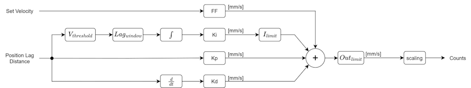

Position Controller 1:
Explanation
FF
Feed Forward - The velocity setpoint is multiplied by this factor and added to the controller's total output.
Vthreshold
If the actual velocity is greater than the Integrator Threshold Maximum Velocity parameter or less than the Integrator Threshold Minimum Velocity parameter, the integrator's control component is no longer adjusted. The Integrator Threshold Minimum Velocity is usually a negative value.
Lagwindow
If the magnitude of the position lag is less than the Integrator Lag Window Minimum parameter or greater than the Integrator Lag Window Maximum parameter, the integrator's control component is no longer adjusted. Integrator Lag Window Minimum and Integrator Lag Window Maximum must be positive.
ILimit
Limit on the integral component of the controller
OutLimit
Limit on the controller's output variable
