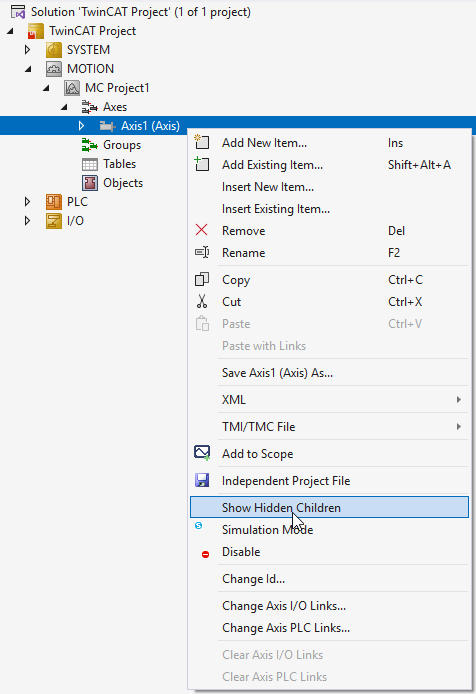

Show drive modules
The drive modules for an axis are hidden by default.
1. Right-click on Axes > Axis > Show Hidden Children to display them.
