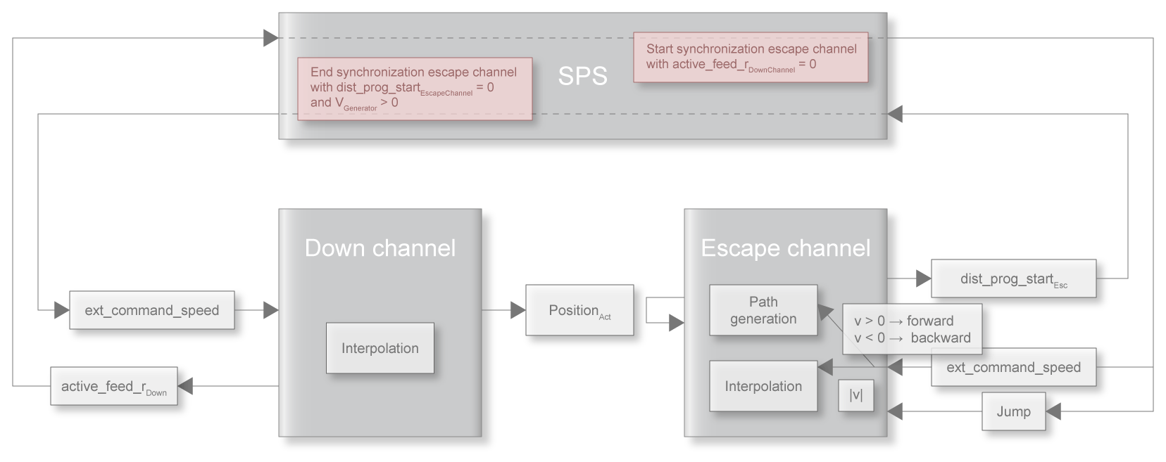

Control by the PLC
The PLC can fully monitor and control the synchronisation of the down channel and escape channels, i.e. the PLC can achieve the required response using the appropriate interfaces.
Superimposing geometry and escape motions 1:
The PLC controls down and escape motions.
In standard machining operations, the escape channel only superimposes the down channel until the down channel is at standstill. This condition is monitored by the CNC while erosion takes place on the path and if ignored, it results in an error message and a machining process abort.
During the orbiting phase, it is possible to simultaneously move and superimpose the two channels. The escape path is adapted online to the changed start position of the down channel. Superimposition results in a type of looping of the escape and geometry motions.

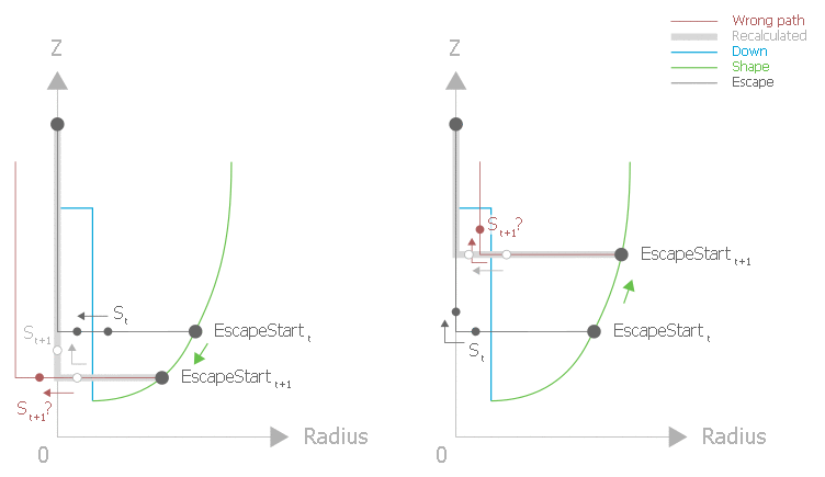

Superimposing geometry and escape motions 2:
Adapting the escape path with simultaneous change in position of the down channel
However, superimposition may lead to dynamic problems. In this machining operation, the electrode can be “pushed” over corners without a motion stop at the bending point. In the worst case, this can result in additional axis acceleration.

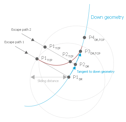

Application example - superimposed escape motion
Sliding end of the escape motion
Superimposing geometry and escape motions 8:
Geometric diagram of superimposed escape motion
When the electrode returns to the contour after withdrawing through the escape channel, the simultaneous commanded velocity specified by the PLC on the down and orbit channels allows a soft return to the workpiece as of a specified distance.
This distance defines a circular area about the starting point of the down channel and can be defined by the dist_prog_start control unit [HLI, section: Status information of a channel] of the escape channel.
