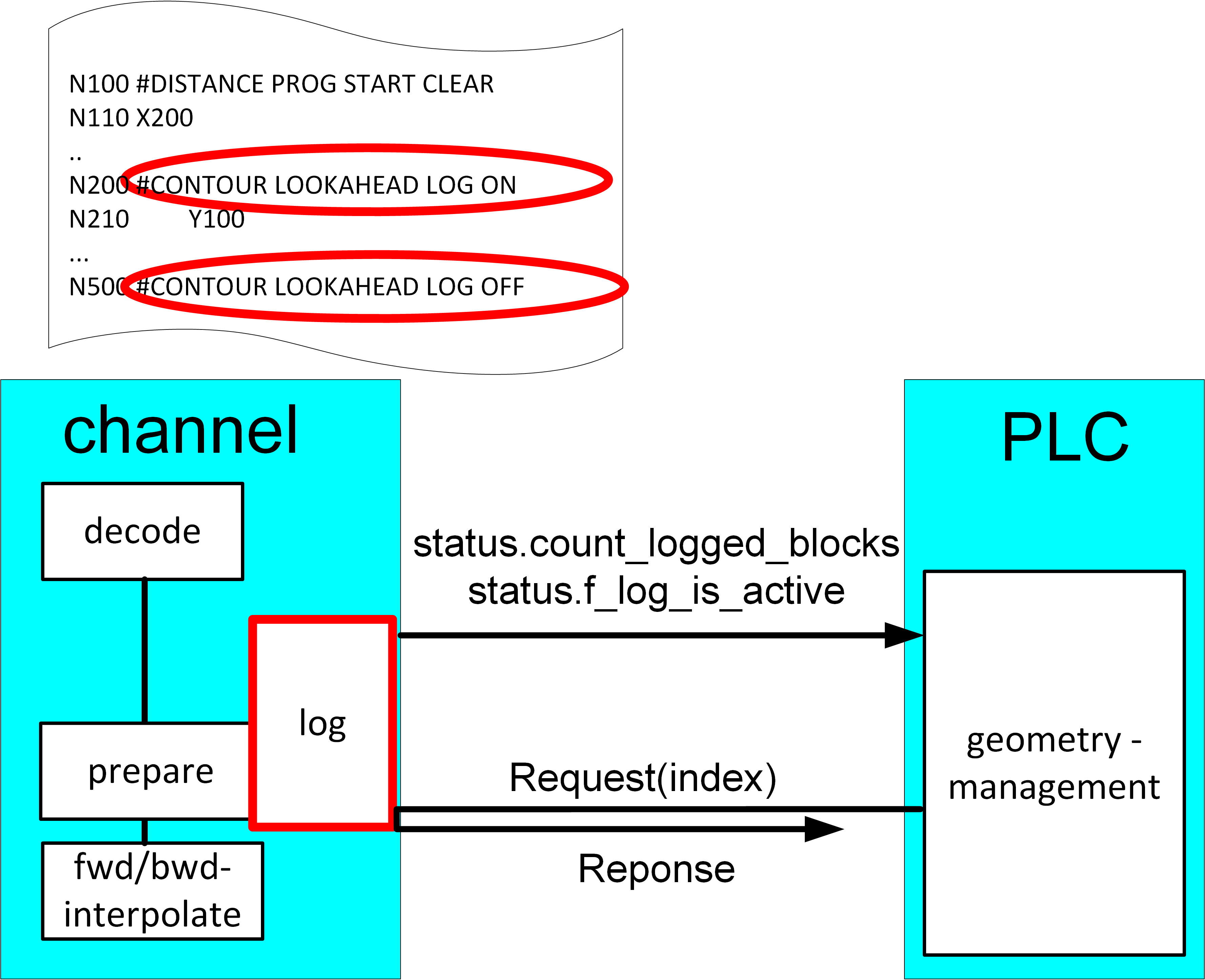

Mode 1 – Request via index 1:
PLC request via index

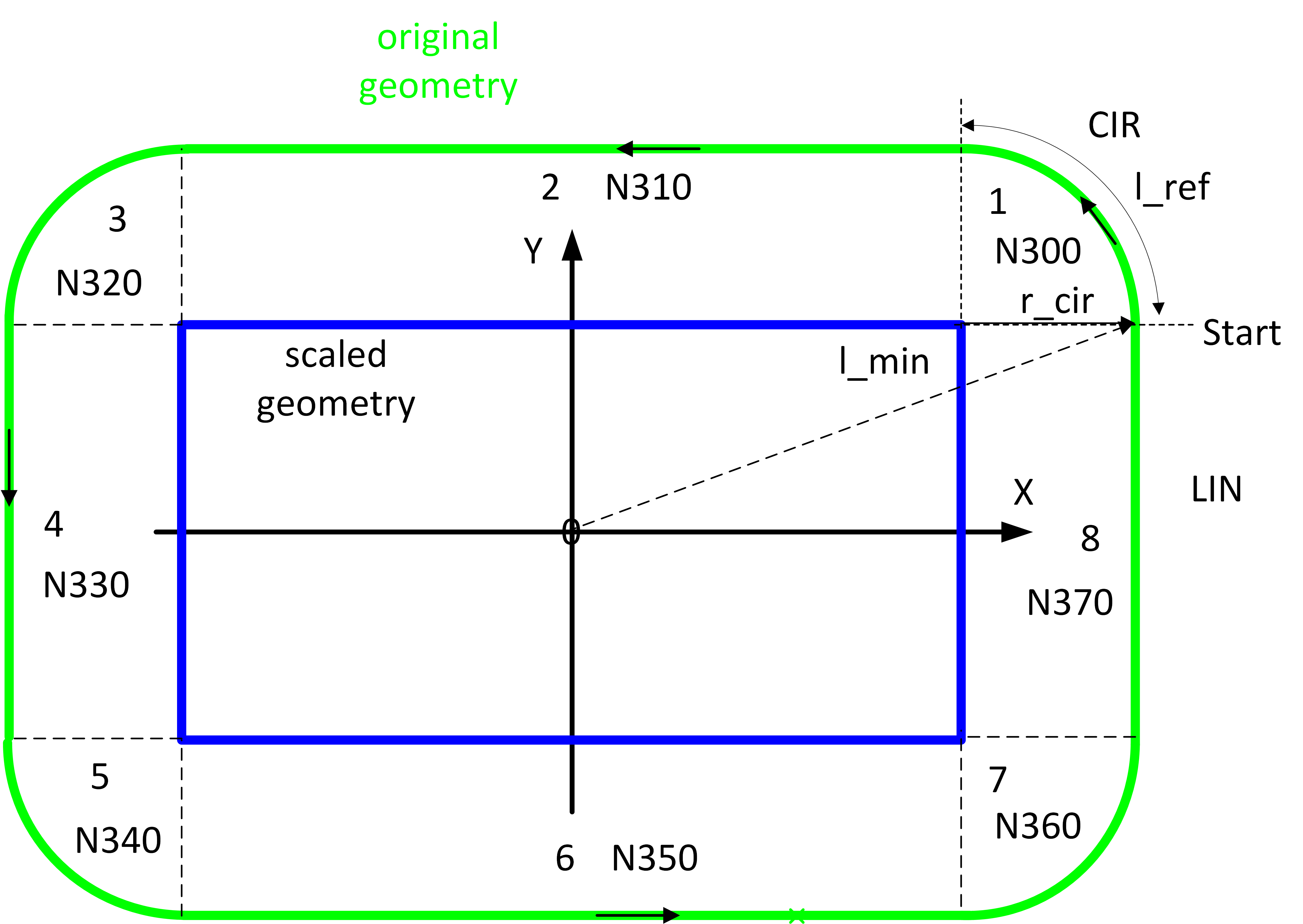

Example of a logged programmed contour
