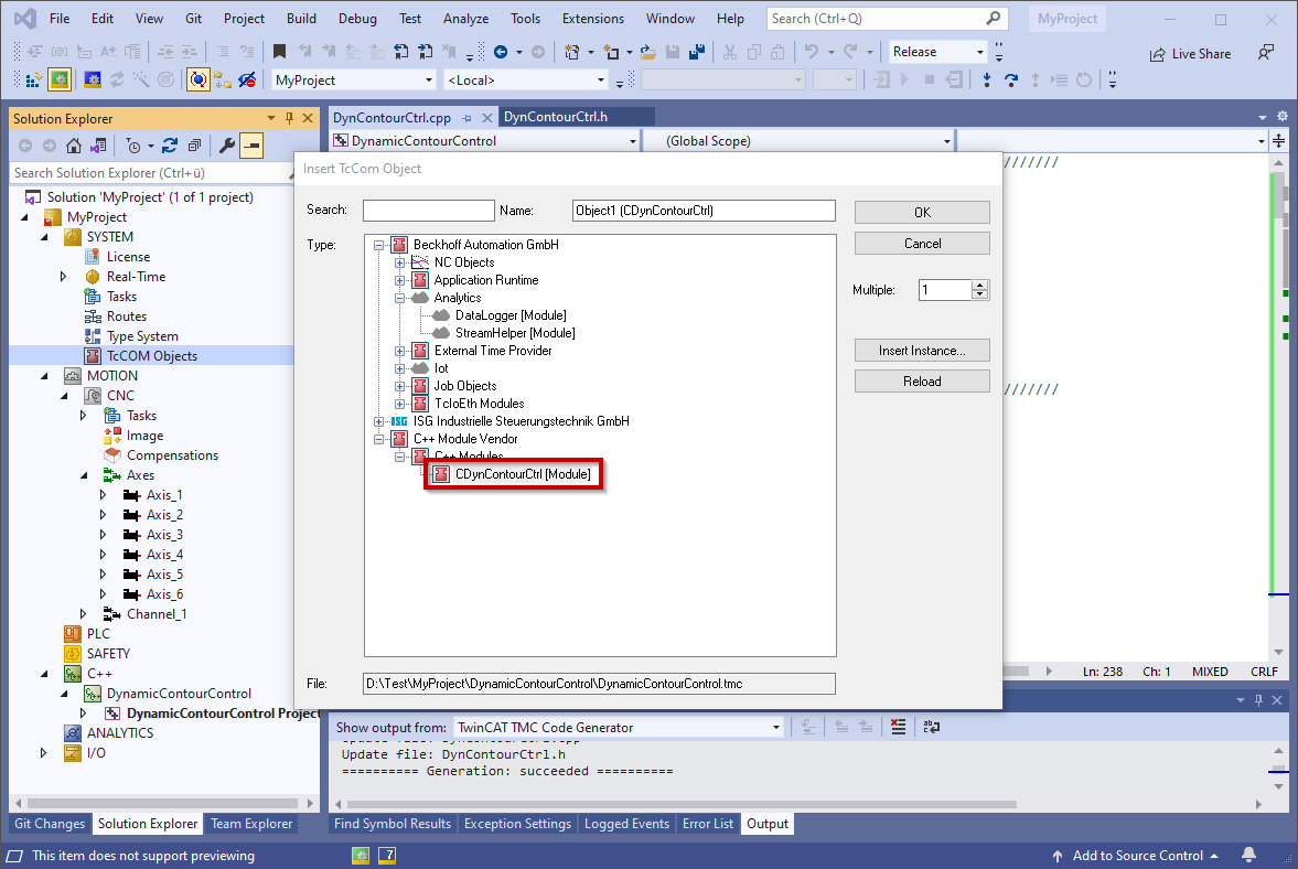

Integrate Dynamic Contour Control object
Integrate Dynamic Contour Control object 1:
Integrating the TcCOM object

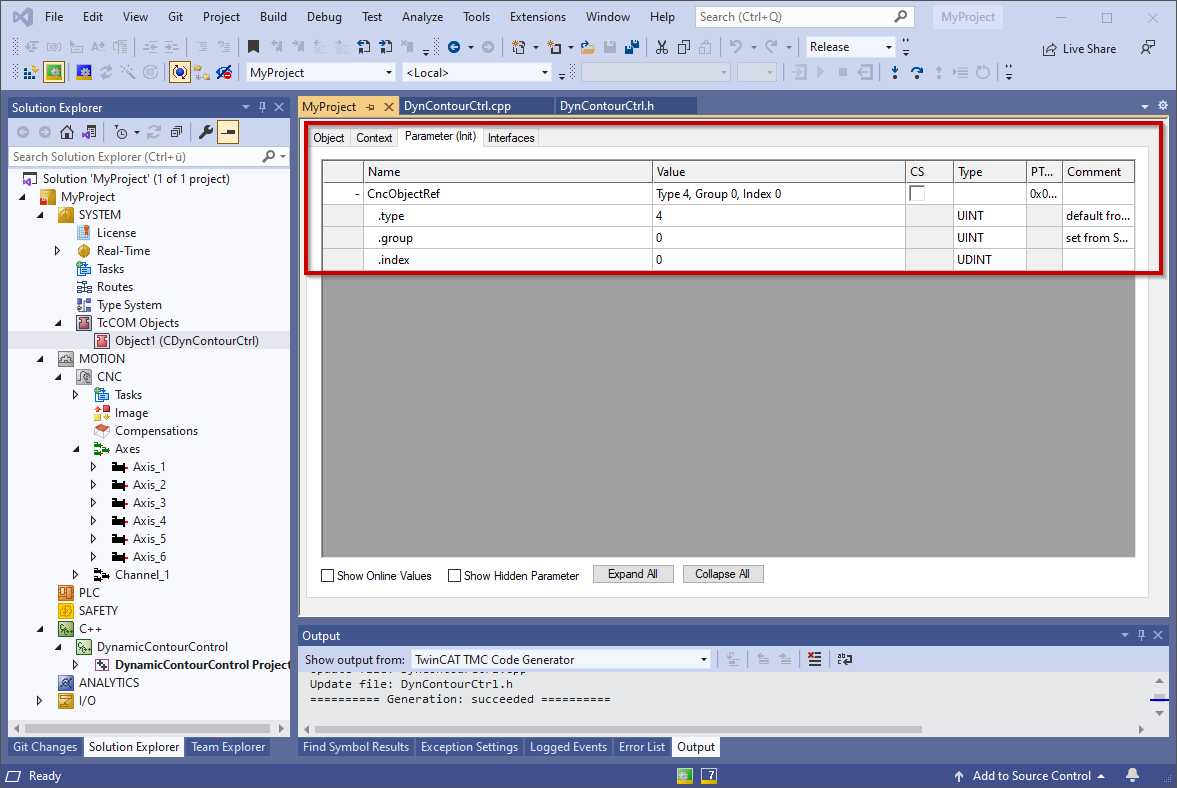

Integrate Dynamic Contour Control object 2:
Properties of the TcCOM object
The type of the Dynamic Contour Control object is 4.
The channel specification is dependent on whether instance-specific variables are used in the TcCOM object.
The index of each object is not used.
The TcCOM object must be digitally signed, otherwise it is not loaded. For more information on TcCOM objects and how to digitally sign an object, go to Beckhoff Information System.
Only one dynamic model can be used for each channel.
