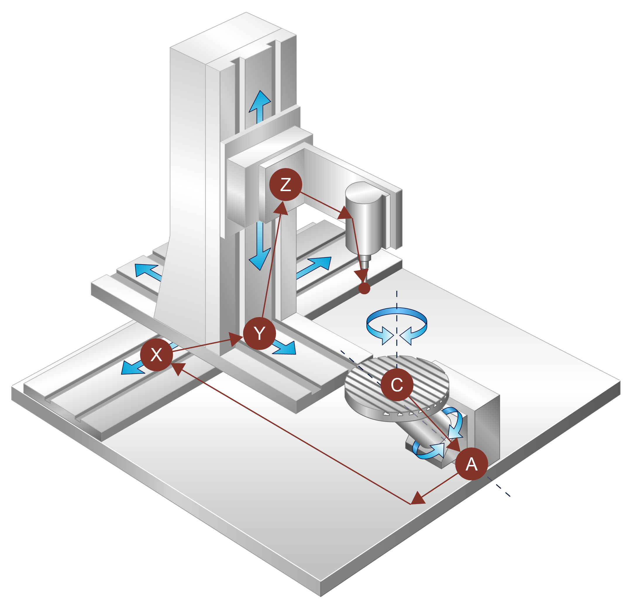

AC machine with workpiece table
Universal Kinematics (ID91) can also be used to map kinematic transformations which are not contained in the kinematics library.
3. Example of an AC machine with cardanic table 1:
Kinematics of 5-axis machine with AC workpiece table
3. Example of an AC machine with cardanic table 2:
Detailed view of the workpiece table
The depicted AC machine with workpiece table shows the linear axes on the tool side and the rotary axes on the workpiece side (as rotators in the tool table). The axes are located in the sequence along the path from the workpiece to the machine origin and from there to
C, A, X, Y, Z
the tool tip. This is the axis sequence in the kinematic chain. However, it must be noted that the orientation vector must be multiplied by -1 for every axis that is located on the workpiece side. This is a possible configuration of the cardanic AC machine:
Configuration of an AC machine with workpiece table:
