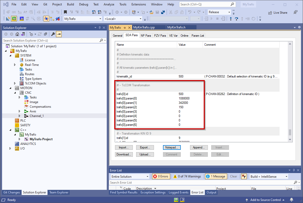

Channel parameter
Example
Channel parameterisation example
# Define the standard transformation
kinematik_id          500       ( P-CHAN-00032)
# -- TcCOM Transformation
trafo[0].id           500       ( P-CHAN-00262 )
trafo[0].param[0]     1088000   ( P-CHAN-00263 )
trafo[0].param[1]     342000
trafo[0].param[2]     150
trafo[0].param[3]     0
trafo[0].param[4]     0
trafo[0].param[5]     0
trafo[0].param[6]     0
trafo[1].id           9
trafo[1].param[0]     120000
trafo[1].param[1]     100000
trafo[1].param[2]     120
trafo[1].param[3]     0
trafo[1].param[4]     0
