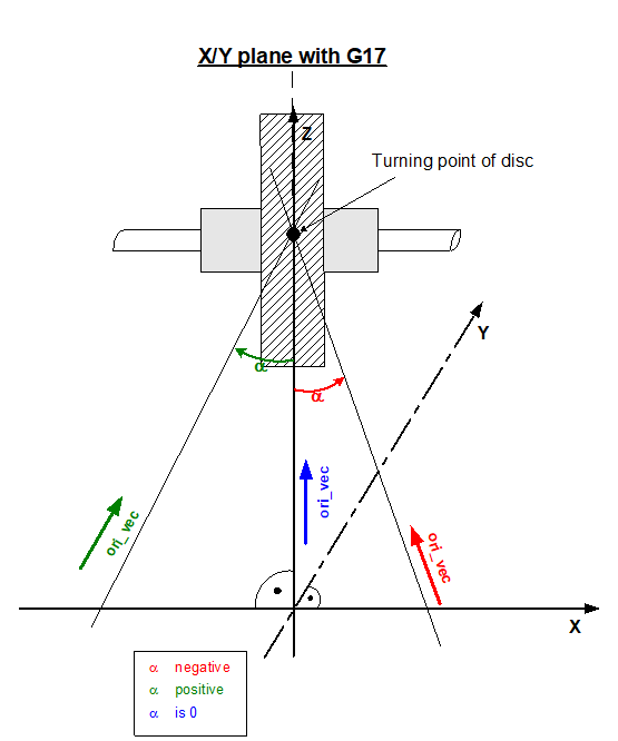

Grinding disc tilt angle (P-TOOL-00138)
P-TOOL-00138
The parameter defines the angle between the centre line of the grinding disc and the 3rd main axis for tilted grinding discs.
Parameter
wz[i].grinding_disc_tilt_angle
Data type
REAL64
Data range
-45°≤ grinding_tilt_angle ≤ 45°
Dimension
0.0001°
Default value
0
Remarks
Grinding disc tilt angle (P-TOOL-00138) 1:
