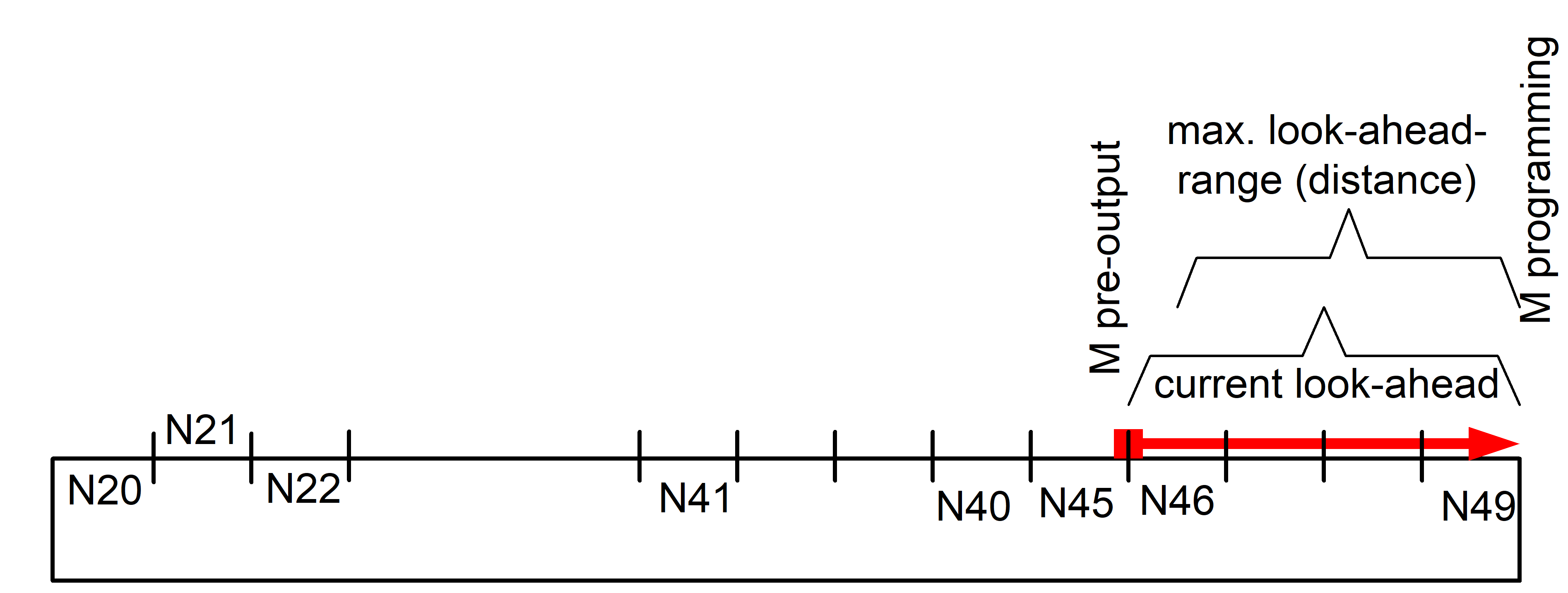

This parameter sets an additional limitation of the look-ahead range for the pre-output of M functions (see [FCT-C1]) to a maximum distance.
If this maximum distance exceeds the sum of all currently considered motion blocks (except for the ‘oldest’ motion block), the ‘oldest’ motion block is output. In other words, an M function can be pre-output by at least the specified distance.

If the maximum number of blocks P-STUP-00061 is set to a high value, it may cause a long delay in channel reaction. To avoid this, a distance limit can also be specified. With long motion blocks in particular, this maximum distance is already reached after a few blocks. This prevents additional delay caused by saving motion blocks in the pre-output of M functions.
Without an explicit specification, the range is not additionally limited (only by the number of blocks P-STUP-00061).
If a pre-output is set greater than the distance currently saved in the look-ahead range, the M function is pre-output at the maximum known path position and a warning is issued.

Maximum path for pre-output of M functions (P-STUP-00062) 1:
Distance-related limiting of pre-output to maximum look-ahead range.
