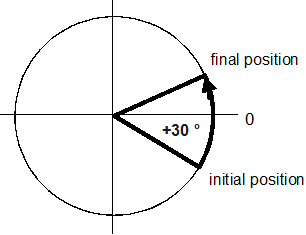

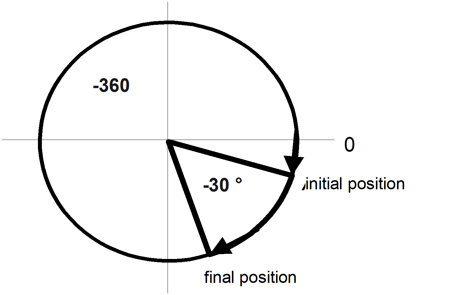

Programming in incremental dimensions (G91)
- The value assigned to the axis indicates the amplitude of rotation of the axis with reference to the previous position. The first sign of the value after the axis name always defines the direction of rotation. Additional signs are not permitted in incremental programming.
Example (assuming: 360° modulo)
- If the value is greater than the modulo value, the number of revolutions is taken into account. Therefore, a motion of more than one revolution is permitted.

Programming examples of modulo programming in relative dimensions
G91 G1 C+30
G91 G1 C-30
