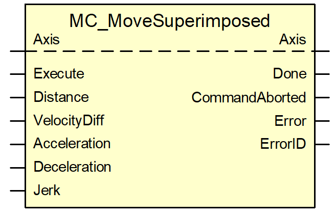

Block diagram of the function block in PLCopen:

MC_MoveSuperImposed command 1:
Distance
[0.1 µm or 10-4 °]
VelocityDiff
[1 µm/s or 10-3 °/s]
Acceleration
[1 mm/s2 or 1°/s2]
Deceleration
[1 mm/s2 or 1°/s2]
Jerk
[1 mm/s3 or 1°/s3]
