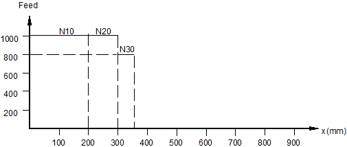

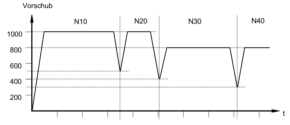

Programming Example

Programming Example
Programming Example
