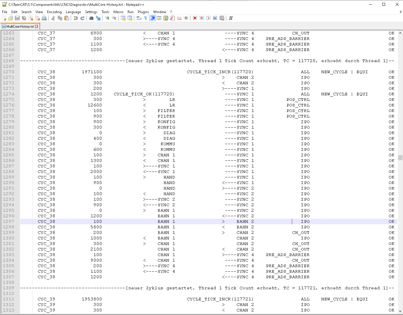

Example of outputs
The output format, e.g. the MultiCore-Startup.log, looks like this:

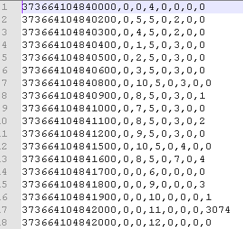

Diagnostic options 2:
Internal logging format
The representations below are produced by an internal tool to prepare the above output format.

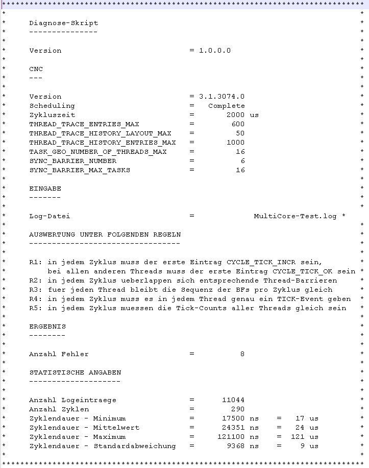

Example output of a MultiCore schedule diagnostic file
Each MultiCore log file contains internal context information at the start, such as version number, schedule type, cycle times, etc., which make it easier to diagnose error response.
Diagnostic options 4:
Script example
