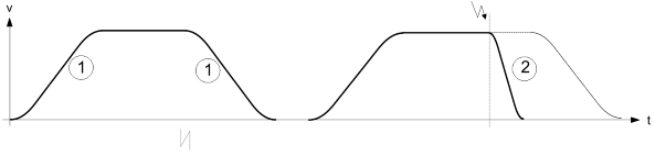

P-CHAN-00296
Active dynamic for measurement run
The measurement travel profile planning is executed based on G00 dynamic parameters. In general, this ensures that the system can stop the motion in good time if the probe deflection is limited.
If the measurement travel profile planning must be executed with G01 values, set the parameter to 1.
The deceleration ramp used when the measuring signal is received is always dependent on P-CHAN-00097 and P-CHAN-00214.
Parameter
meas_use_std_dynamic
Data type
BOOLEAN
Data range
0: The measurement travel profile planning is executed based on rapid traverse acceleration values (G00) dependent on P-CHAN-00097 and P-CHAN-00214 . The CNC functions for acceleration and ramp time weighting are not effective here.
1: The dynamics of the measurement travel is dependent on P-CHAN-00097 and P-CHAN-00214 and is executed based on the dynamics of feed blocks (G01). CNC functions for acceleration and ramp time weighting can be used here.
The deceleration ramp used when the measurement signal is received is always a_feedh.
Dimension
Default value
0
Remarks
Parameterisation example:
meas_use_std_dynamic    1
The effective dynamics dependent on the parameters P-CHAN-00097 and P-CHAN-00214 are shown in the table below. Channel parameters 1:
