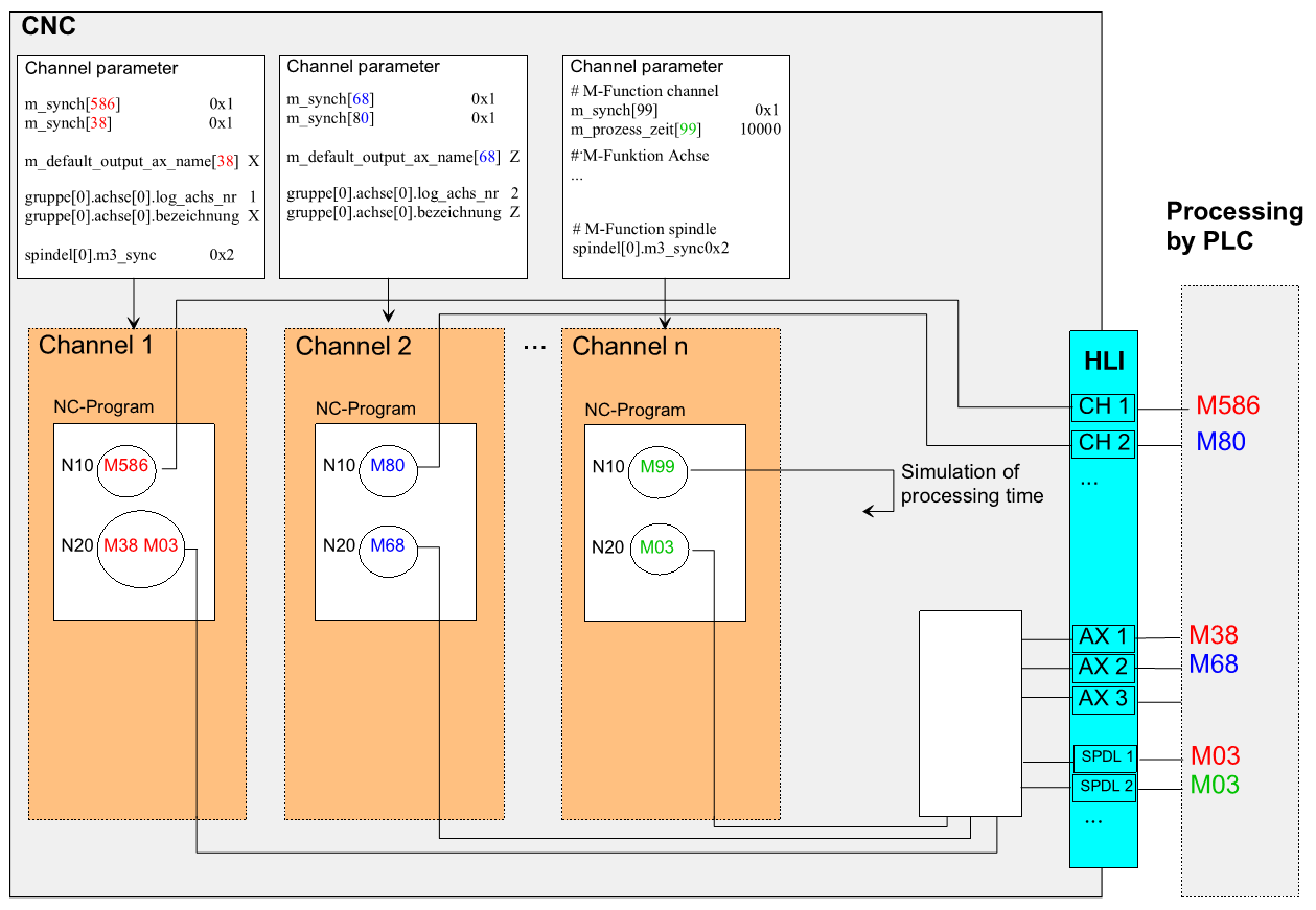

The timing of the output of M and H functions to the PLC and its subsequent reaction can be synchronised in various ways with motions to be executed.
To simulate the machining time of an M or H function, a time period can be specified in order to determine the run-time of a CNC program.

The CNC channels are each parameterised via an initialisation list (see Channel parameter list). All M and H functions must be specified here. Instead of a channel-specific assignment, an axis-specific assignment and a synchronisation method can be defined.
At the interface to the PLC (High Level Interface) [HLI], M and H functions are output in the channel and axis-specific areas and the PLC further processes them and confirms them accordingly.

Output
The following options are provided for output to the PLC:
- No output
- Before / after a motion
- After an event
Output to the PLC (HLI) can take place in different ranges of the interface:
- In the channel range
- In the axis range
Synchronisation
The following options are available for synchronisation with a motion to be executed:
- No synchronisation
- Synchronisation at the transition to the next motion block with machining feed rate ('late' synchronisation implicit)
- For an explicit request ('late' synchronisation explicit)
- During a motion block (example: edge banding)
