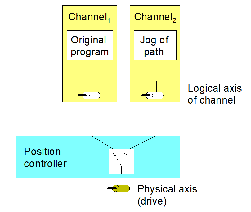

Inserting a path motion can be implemented by using an “auxiliary channel”. In this document, an “auxiliary channel” is referred to as a jog-of-path channel.
A jog-of-path channel contains linked axes which are connected to the same physical axes as the axes in the actual channel.
Switchover
Channels are switched over by the PLC. Exclusive access of a channel to physical axes is controlled by a control unit provided for each channel.
Position offset
When an axis is moved by an inserted path motion, it also retains the offset in the original channel as soon as this channel regains access to the axis.
