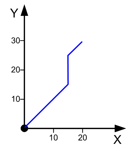

2 channels are configured. In channel 1, the Y axis is configured with log axis no. 2 and in channel 2, the cloned axis is configured with the log. axis no. 11.
Configuration of an additional logical axis 11 for physical axis number 2
kopf.achs_nr               11
kopf.link_to               2
kopf.clone_of              2
Actions
  1. Start manual block “G01 G90 X20 Y20 F100” in 1.Kanal 1
  2. Set ”Suspend-Output” in the channel 1 to 1
  3. Clear ”Suspend-Output” in the other channel 2
  4. Start manual block “G91 Y10” in channel 2 and wait until it ends its execution
  5. Clear “Suspend-Output” in channel 1
  6. Set “Suspend-Output” in channel 2
Application examples 1:
Position sequence of the example
Alternatively, a motion can be started in manual mode in channel 2 instead of the manual block.
