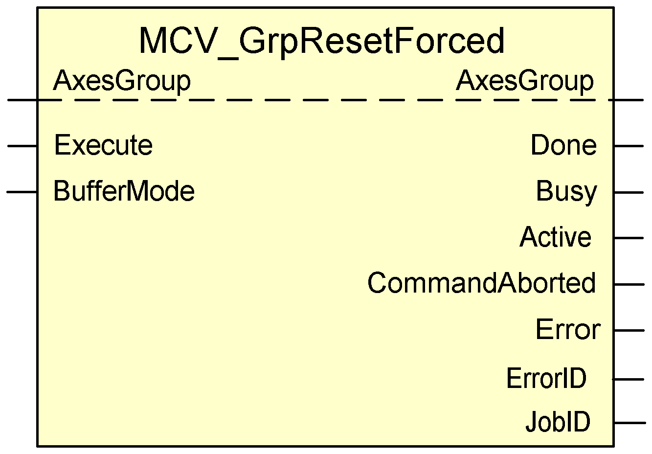

Block diagram
FB parameters
VAR_IN_OUT | ||
Variable name | Data type | Description |
AxesGroup | AXES_GROUP_REF | Axis group reference |
VAR_INPUT | ||
Execute | BOOL | Starts the command on the rising edge. |
BufferMode | MC_BUFFER_MODE | The input defines when a job is activated provided that other jobs are already active when the FB is commanded or are waiting for execution. The following modes are supported: mcAborting = 0 mcBuffered = 1 |
VAR_OUTPUT | ||
Done | BOOL | TRUE indicates that 0 velocity was reached. The axes are at standstill. |
Busy | BOOL | TRUE indicates that the function block is executing a job. |
Active | BOOL | The command is not yet completed. |
CommandAborted | BOOL | The command to stop was aborted by another command. |
Error | BOOL | TRUE indicates that an error occurred. |
ErrorID | WORD | Error code |
JobID | UDINT | Ordinal number of the last job sent by the FB. |
