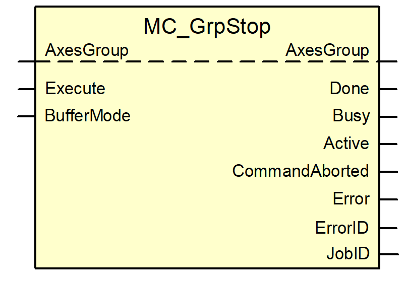

MC_GrpStop
The function block leads to a controlled motion stop. It aborts every ongoing command by other motion FBs.
The axis group changes to the “GroupStopping” state until velocity 0 is reached. If the “Done” and “Execute” outputs are set to FALSE, the axis group state changes to “GroupStandby”. The function block is not interruptible.
Block diagram
MC_GrpStop 1:
FB parameters
Variable name
Data type
AxesGroup
AXES_GROUP_REF
Axis group reference
Variable name
Data type
Execute
Starts the command on the rising edge.
BufferMode
MC_BUFFER_MODE
The input defines when a job is activated provided that other jobs are already active when the FB is commanded or are waiting for execution. The following modes are supported:
mcAborting  = 0
mcBuffered  = 1
Variable name
Data type
Done
TRUE indicates that 0 velocity was reached. The axes are at standstill.
Busy
TRUE indicates that the function block is executing a job.
Active
The command is not yet completed.
CommandAborted
The command to stop was aborted by another job.
Error
TRUE indicates that an error occurred.
ErrorID
WORD
Error code
JobID
UDINT
Ordinal number of the last job sent by the FB.
