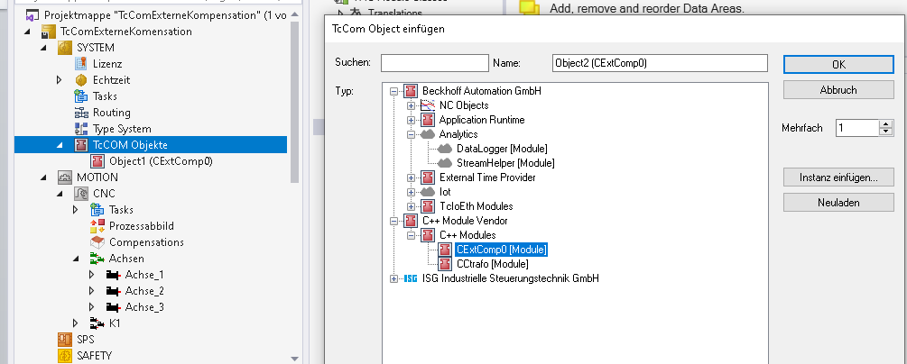

Loading the compensation object
After the object is successfully generated, the object can be added to the XAE project.
Loading the compensation object 1:
Adding a TcCom object in TwinCAT
Then the type, index and group of the object must be configured.

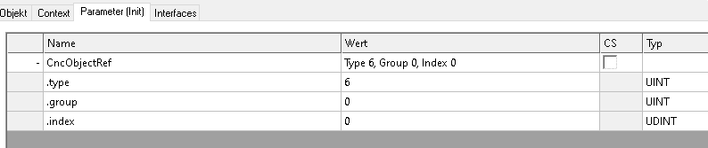

Loading the compensation object 2:
Configuring the parameters
The TcCOM object must be signed, otherwise it is not loaded. For more information on TcCOM objects and how to sign an object, go to Beckhoff Information System.
