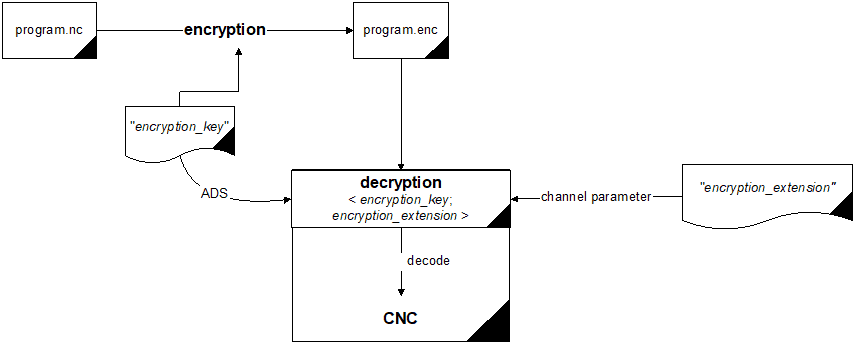

The following steps are required to use an encrypted NC program:
  1. An NC program is encrypted with an individual key and saved to a folder.
  2. The file extension is entered in the channel parameter list as an encrypted file type for the corresponding channel.
  3. In parallel to the file extension, the associated key used to encrypt the file is entered in the NC kernel. The entry is made by using a write operation to a CNC object. This can be executed by the PLC.
Process
When an NC program is invoked, the NC kernel detects from the file extension whether it is encrypted. If the NC program is detected as encrypted, the kernel decrypts it using the specified key. If the file extension is defined as not encrypted, the program is processed as a normal NC program.
Notice
If the key is incorrect, the file is still decrypted. The NC kernel attempts to process the file and normally this then results in a syntax error.

Flow chart
Description 1:
Encryption/decryption flow chart of an NC program
