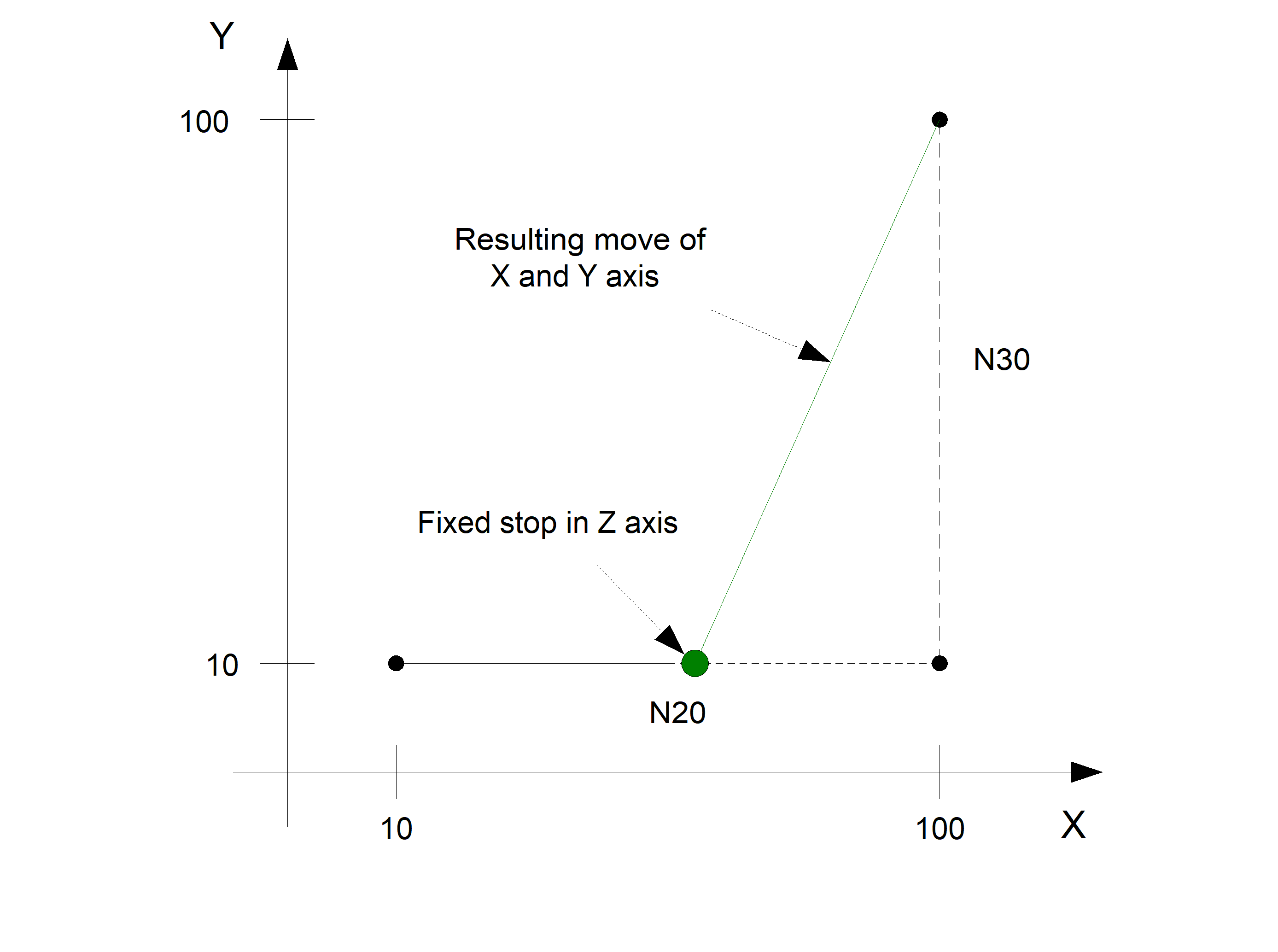

Delete distance to go in the approach block with non-participating path axes
The “Move to fixed stop” function can be active simultaneously in any number of axes. In addition other axes can be moved together in the approach block even if they do not move to the fixed stop.
If all axes in the approach block detected the fixed stop, the block distance to go is discarded. If other axes participate in the motion but do not move to the fixed stop, these axes continue to move towards the target point of the next motion block starting at the abort motion.
Programming Example
Discard distance to go
N10 G01 X10 Y10 Z0 F1000
N20 G01 X100 Z100 Z[FIXED_STOP ON TORQUE_LIMIT10]
N30 G01 Y100
Programming 1:
Deleting distance to go

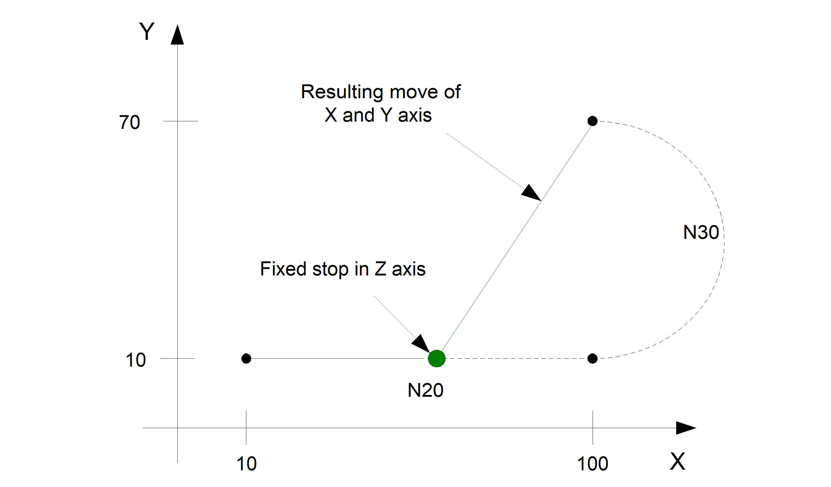

A circular motion following the approach block is converted to a linear motion; the axes approach the target point of the original circular segment directly, as shown in the example below.
Programming Example
N30 G03 Y70 J+30
Programming 2:
Circular motion converted to linear motion
