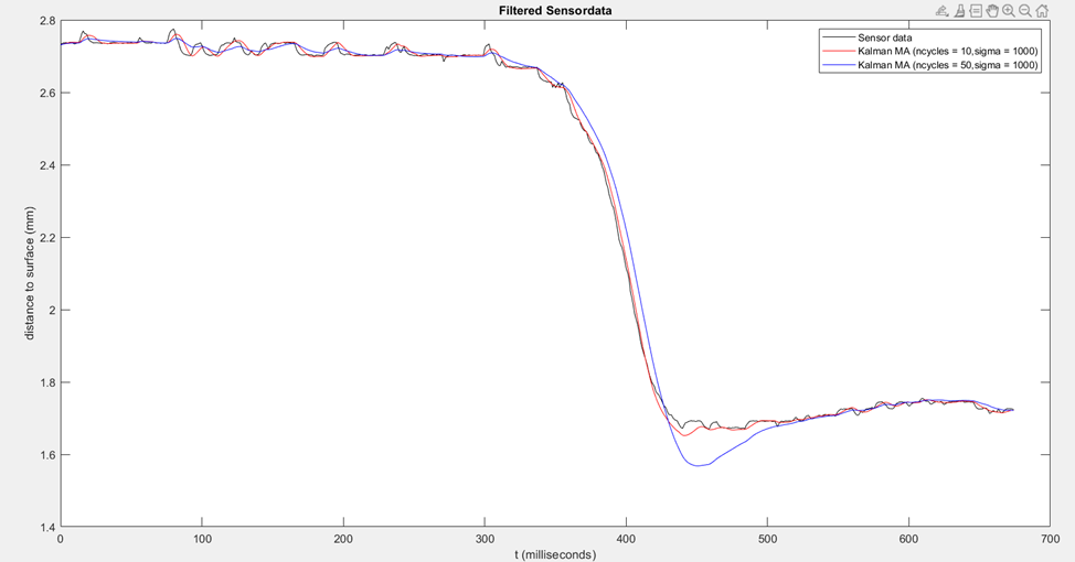

Influence of parameters: 1:
Different filter effect with varying n_cycles

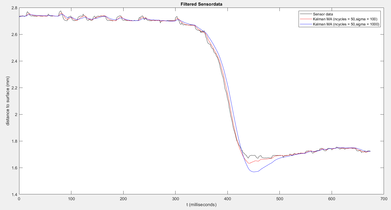

Influence of parameters: 2:
Different filter effect with varying sigma
