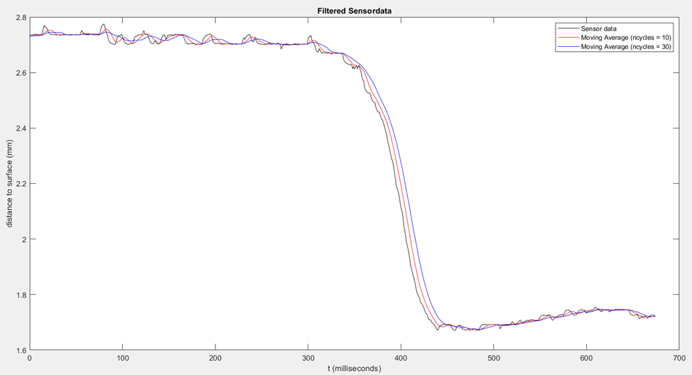

It is possible to achieve good smoothing of sensor data with a moving average filter. However, smoothing sensor data causes a relatively large delay in the system. The following conditions for the parameters are active: The more measured values are included in the filter via P-AXIS-00413, the better the smoothing, but the greater the reaction delay involved.
Moving averaging filter 1:
Different filter effect with varying n_cycles
