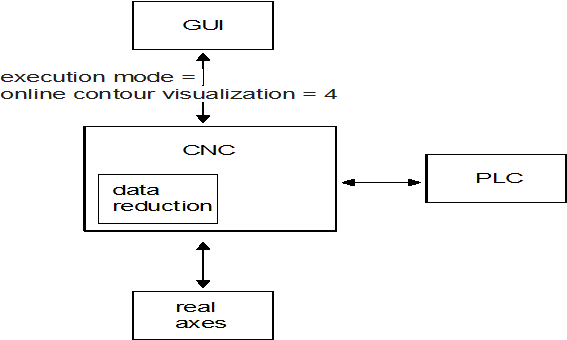

Online contour visualisation
Activation
Online contour visualisation is activated by transferring the program start option ON_LINE on the HLI to the controller at program start (see documentation on the HLI).
As opposed to rapid contour visualisation, the online contour visualisation mode executes the real processing of the NC program. The read-out values are filtered to obtain a high-performance data transfer.

Parameterisation
Parameterisation takes place analogously to Rapid Contour Visualisation (see “Parameters”.)
Online contour visualisation 1:
