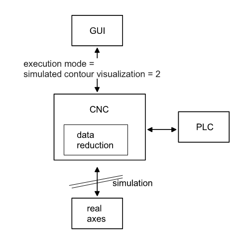

Rapid contour visualisation is activated by transferring the program start option SOLLKON on the HLI to the controller at program start (see documentation on the HLI).
No axis motions are executed with Rapid Contour Visualisation. Visualisation data is output in a reduced grid. The required interpolation point grid or the permitted secant error must be specified for the interpolation. The NC program is executed faster as a result of the sample grid.
Programmed dwell times (G04, #TIME) are ignored.

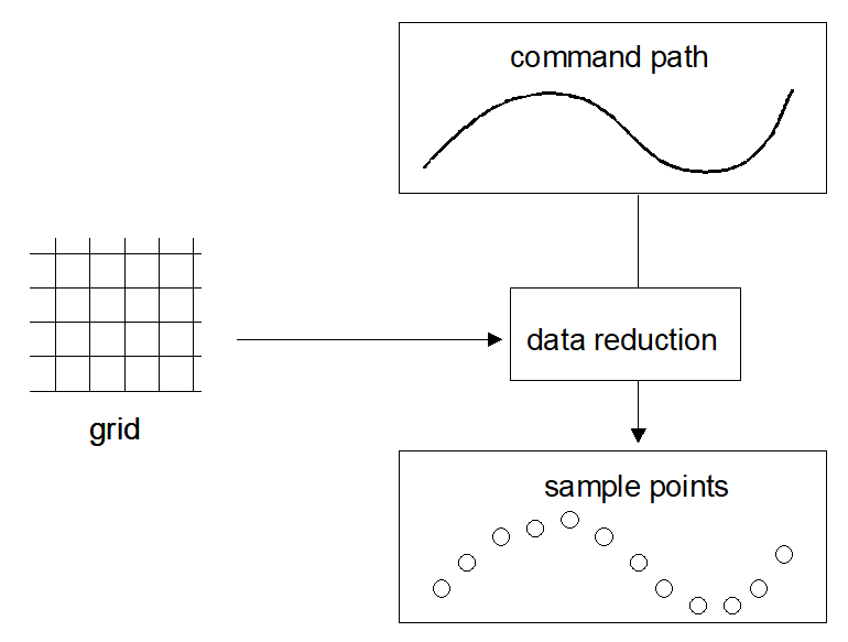

Sample grid
Depending on the motion block used (straight/curved), the interpolation point grid can be specified for the interpolation either
- by specifying a maximum interpolation point interval
- or by specifying a maximum path error
This can be defined in the following parameters:

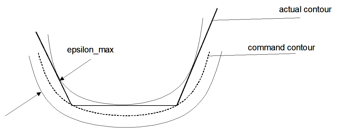

Interpolation point grid for curved contour elements
An
- absolute secant error
- and a relative secant error
εmax = r*εrel for: εrel <= εabs
εmax = εabs for: εrel >= εabs
The resulting second error is the smaller of the two values.
