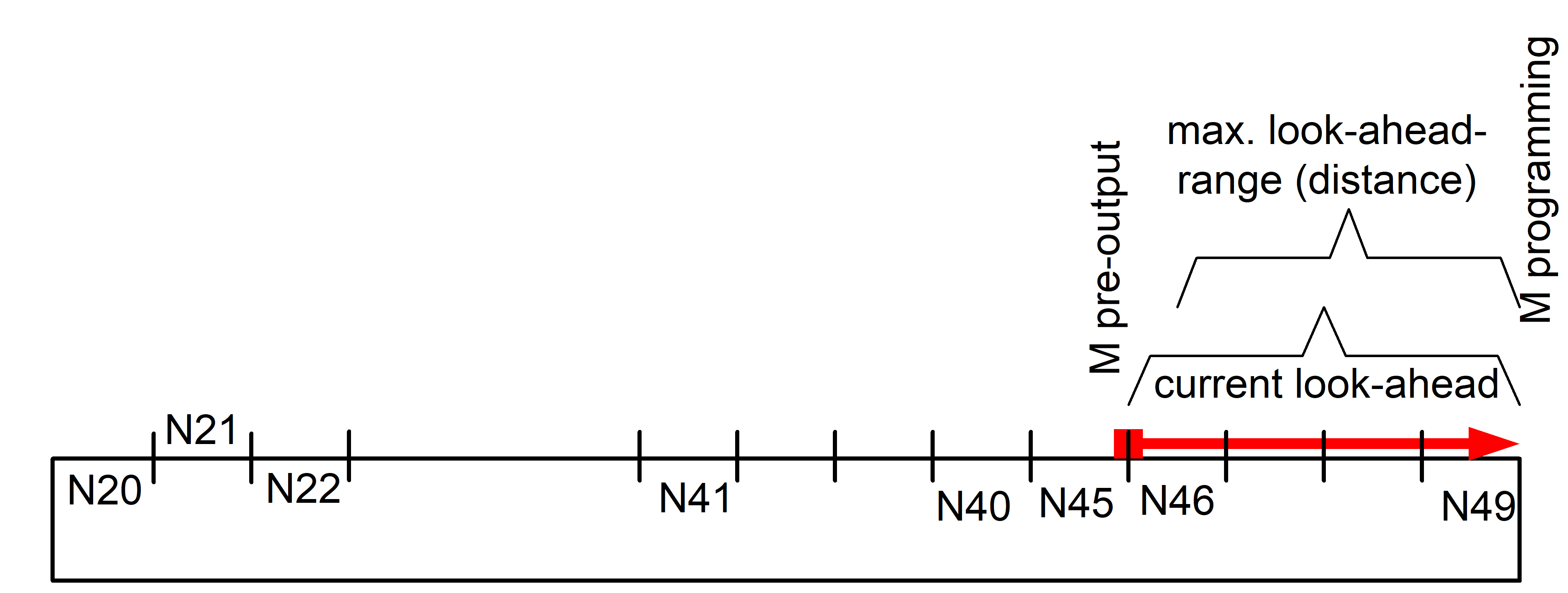

If a pre-output is set greater than the distance currently saved in the look-ahead range, the M function is pre-output at the maximum known path position and a warning is issued.

; Warning 120693: -> MicroJoint due to distance limitation 3.5mm

Maximum path for pre-output of M functions (P-CHAN-00604) 1:
Distance-related limiting of pre-output to maximum look-ahead range.
